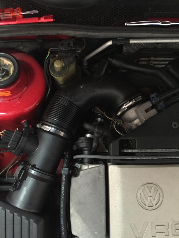

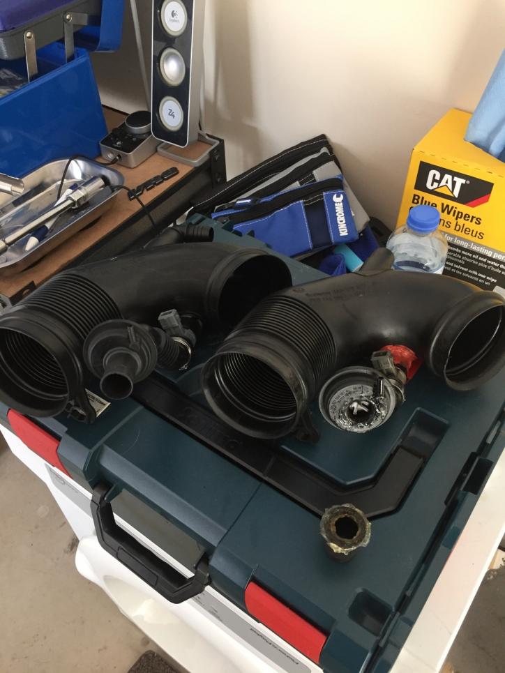

      Finally got my hands on a new PCV valve and intake boot. I hope that i don't need to ever purchase another one again as the PCV/intake boot which can only be purchased new as a whole unit is now a discontinued part for the earlier VR6 with the port at the back that has a hose which runs to the ISV. The later VR6 PCV/intake boots are still in circulation FYI.
      Fuaaark you whoever came up with the idea of selling it as a whole unit (insert the middle finger) lol
      New vs Old
      Ahhhh now thats more like it

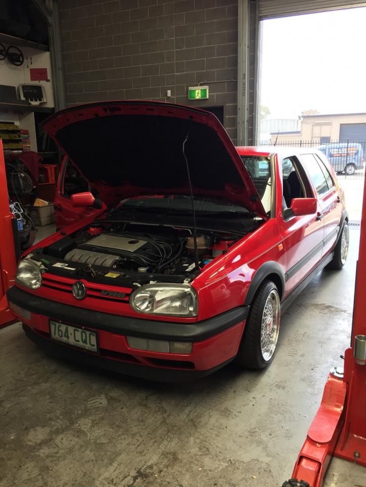

      • #18
        Going over it one more time before she goes in for a blue slip tomorrow! Pretty excited i might order some Euro plates to mark the occasion just unsure if i go the white and blue or black and gold plates???

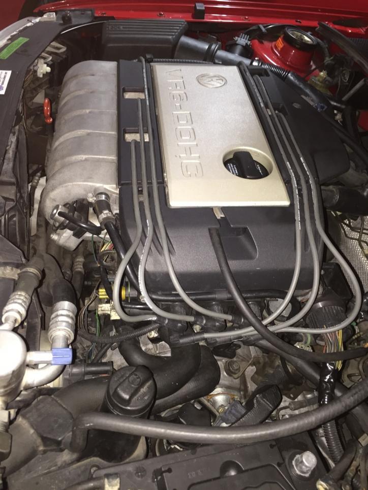

                      • #26
                        So this just happened

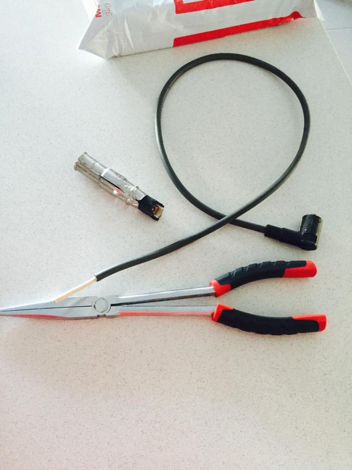

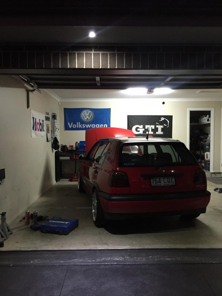

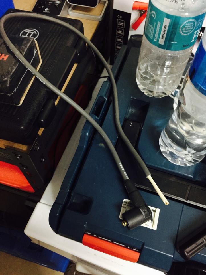

                        Went to drop a fresh set of spark plugs but i couldn't get the lead tool onto the base of the Bosch leads so i thought id be ok giving it a yank by hand.... I remember having this issue before on another vr6 of mine were the tool wouldn't latch onto the lead, seems as though the Bosch leads are a litter fatter and the tabs don't line up with both the oem and aftermarket metal lead remover. So she is sitting in the garage going nowhere until a set of leads arrive hopefully in the next few days, im starting to remember why i told myself id never get back into a mk3
                        Had to run into Bunnings to get the longest set of pliers they had.....

                        • #27
                          I bought MK4 leads. They come with easy pull out tabs that also help for installation. Otherwise they are identical to MK3 leads.

                            U can buy the Genuine Bremi leads from VW Village, its a little pricey, but they do last.

                            • #29
                              True? Ive seen them for sale and i did note the difference but didn't know they would work.... Do you have any pics of how they look in the bay particularly the end that connect to the spark plug in the cavity?

                              • #30
                                Don't have any photos but from what I can remember the metal end was longer.
