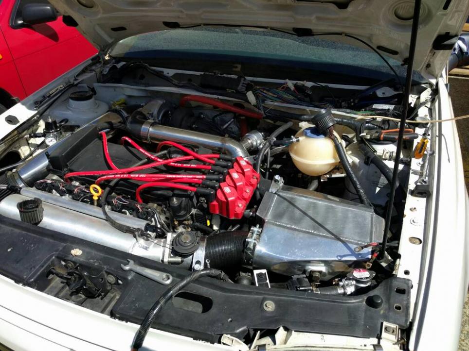

              A few updates but no tune yet guys!
              Car is running but we're just sorting out an alternator charging issue. It ran fine at idle it's just the tune that needs to be done before skids haha.

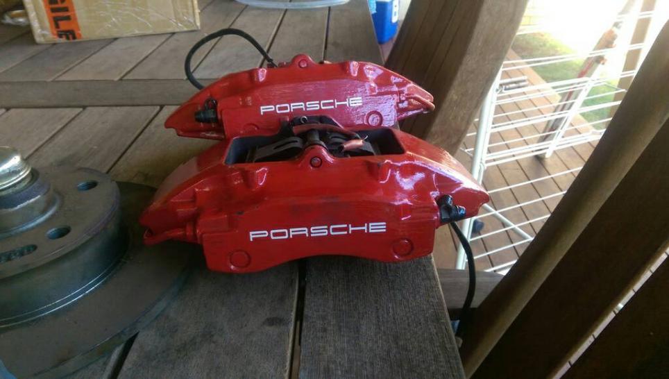

              And some of the good stuff!

                What ecu are you running, is that the issue re the alternator?

                  Running a Haltech PS2000 Speed.
                  And the alternator issue is separate, the ECU runs fine it's just an electrical charging issue.

                    SP mx5's had the same issue with a haltech. Believe the wiring diagrams are incorrect and needed to be patched. That's why I mentioned it.
                    If the ecu is responsible for controlling the alternator regulator than its a possibility. I don't know but thought it worth while mentioning it.
                    Hope it's sorted soon

                      I believe in a VR6 the alternator trigger is in the cluster or something like that.
                      Anyway it's fixed now and the car is getting tuned next week sometime hopefully.

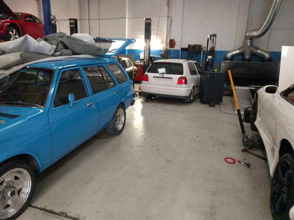

                      Sneaky shot from the rear. It's the only piston car in a shop full of rotaries!

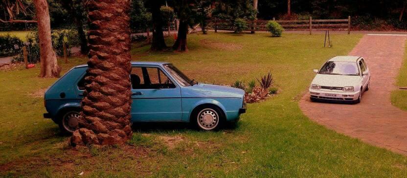

                            I'll put a picture up why not here's my MK1 and my friends MK3 3 Door VR6. It's a shame it's N/A though!
