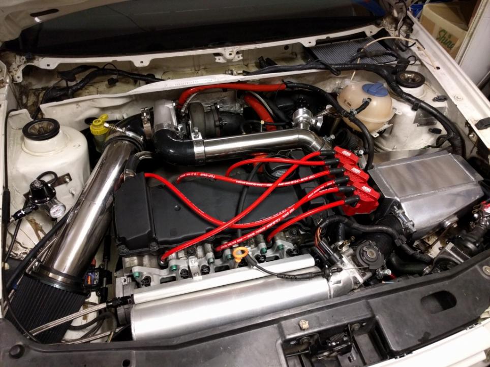

    Oh wow! looks awesome! How come such a small cooler? Forgive me if its a silly question (turbo noob lol)
    Hey mate it's a water to air intercooler. It uses water to cool down the intercooler rather than air so it can be more compact because there's an external radiator which is used to dissipate the heat from the water in the system.
    And thanks guys it's coming along! Just finishing off a few things then it's off to get the tune!

          Added oil catch can, finished some brackets off and did all the vacuum lines, shortened ignition wires, etc etc.
          Car is now complete except the Haltech and tuning!
          I'm excited to get it running hopefully in about a month:
