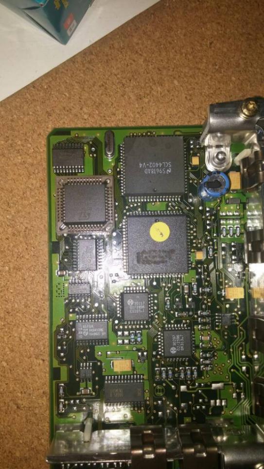

get yourself a magnifying glass and have a really good look at the soldered joints. Have you got it orientated correctly ? Did you make note of where the number 1 pin was?
Originally posted by h100vw View Postget yourself a magnifying glass and have a really good look at the soldered joints. Have you got it orientated correctly ? Did you make note of where the number 1 pin was?
Orientation is correct. As stated above, solder joints might not be right.
There is also a possibility that the chip was killed by some static electricity, were you wearing the anti-static wrist strap while working on it?
Edit; only just saw the last post now, hmm, will have to wait and see then.Past - '95 VW Golf MK3 VR6
A unsoldered pin was found and a couple touched up but still no change :'( . I got my multimeter out and found 2 suspect and 1 unattached pin so going back for another touch up.Last edited by cliftronix; 12-05-2015, 07:46 PM.

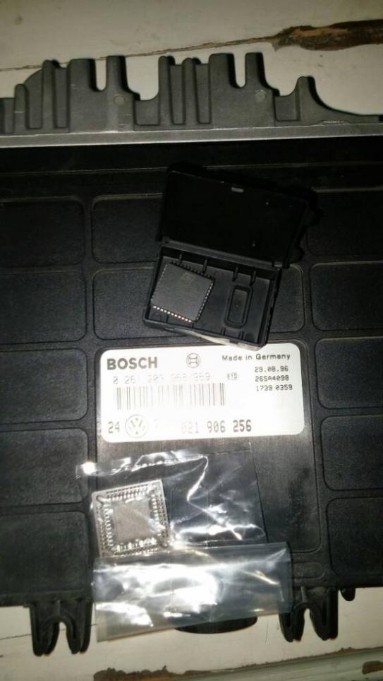

Originally posted by stefcio007 View PostJust out of curiosity, have you tried the old chip in the socket? At least that would tell you if it's the socket or the chip that are having problems.
So 4 days in it finally ****ing works. Jaycar socket wasn't contacting the pins of the chip correctly. Removed the socket (and one pad off the board) and surface mounted it on after much frustration. Started first go.
