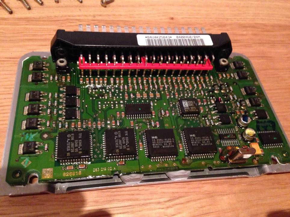

                Okay... So it turns out my VR6 is one of the ones where the ABS/EDS controller is separate from the ABS pump and is under the rear seat, making things 100 times easier.
                I removed it and took it apart and it looks perfect, no loose parts, circuit board looks great.
                Is there any checks I can do to check this sole part for operation?
                Seriously hoping it's not my actual pump that's gone, think it's too big of a job to tackle myself!

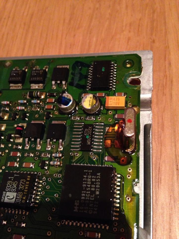

                          Okay so I pulled it apart again and these are the photos. Everything looks fine apart from 1 part...
                          Anyone have any idea what that orange stuff is? Looks like it burst :S.
                          Think I might track down a new ECU and try that 1st before going whole hog and forking out for a new pump.
                          2012 - Tiguan - 155TSI - DSG - Black
                            That thing is a crystal oscillator, they don't burst like that (actually, they don't burst at all). Just looks like someone dropped some glue accidentally as there is also some of it on the other ICs.

                              Ahh okay, you think it might be worth trying another ECU anyway?
