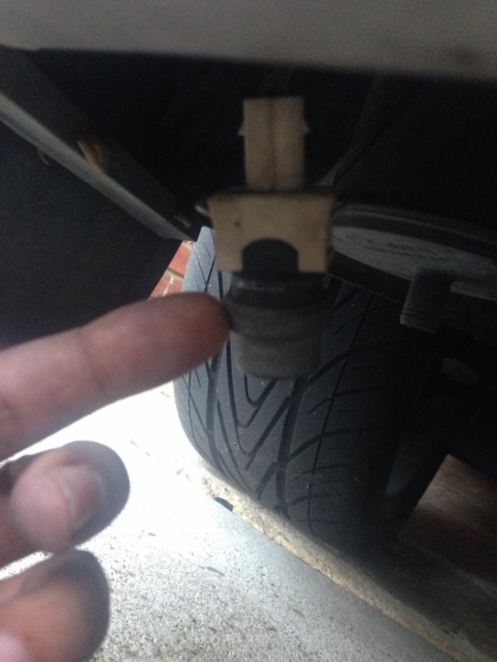

            I did notice this part hanging from the bumper when I got the towed?!?

              I think thats your outside air temp sensor for the MFA?

                Sorry but MFA??? If it helps it's on the left hand side of the car (if you outside the car looking straight at it)

                  I'm assuming you've got a Vr6? If so, your MFA is the thing on your dash that you can switch through to show oil temp, L/100km etc

                    Yep, ahh ok, I take it's not suppose to hang like that. I'll start searching more on it. Thanks DruceJnr
