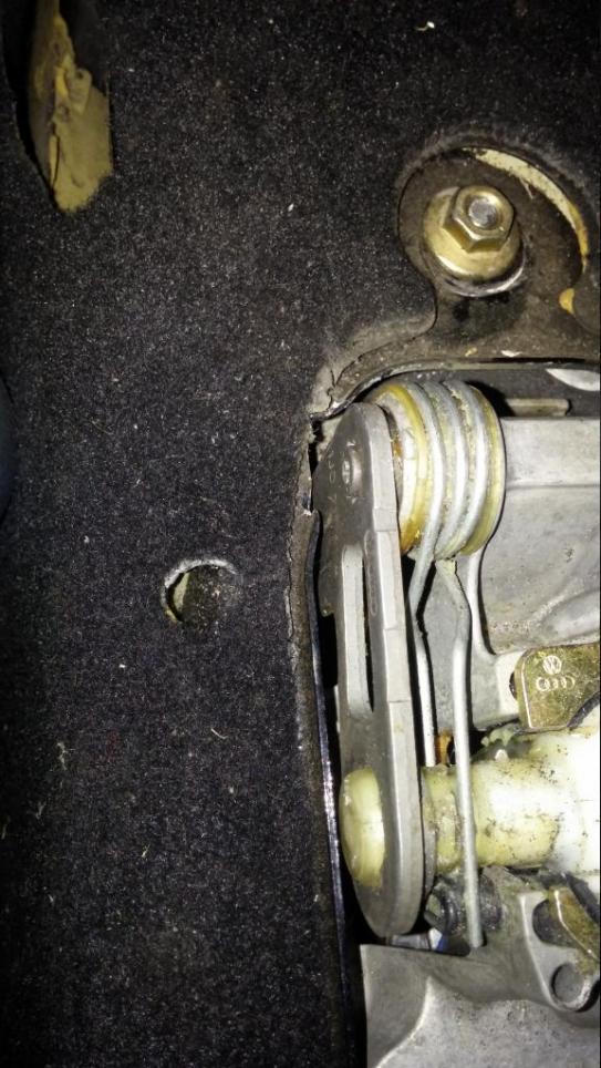

                        Some pics of the mk4 internals transplanted into the tdi shifter housing. As mentioned, I didnt take any photos as far as removing the exiting and putting in the Mk4 is they are really not needed. It is a very straight forward process and took all of 30 minutes start to finish. One thing i did notice however is that the tdi selector bracket still needs to be used due to its curved edge. The Mk 4 is square and doesnt allow for shifting and reverse due the the height of the shifter tower compared to the mk4 housing....

                            The issue isnt that it will hot the side of the tunnel, the tdi shifter housing eliminates this and any cutting of any kind as it bolts direclty into the mk3 VR6 transmisstion tunnel. Pretty sure the same for CL, GL. its the actual mk4 lever (the L shaped piece) that wont work. Simply ket the tdi one and no probs...
