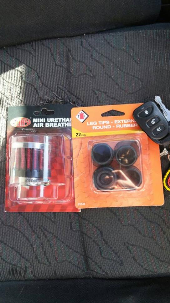

So after having a rough idle and terrible fuel economy over the last week i check under the hood and after a year of ownership the first thing to break and actually need replacing was the pcv valve today, so I made my own pcv delete kit thanks to bunnings and autobahn. Anyone think I will run into any problems not having it vent to the intake?
