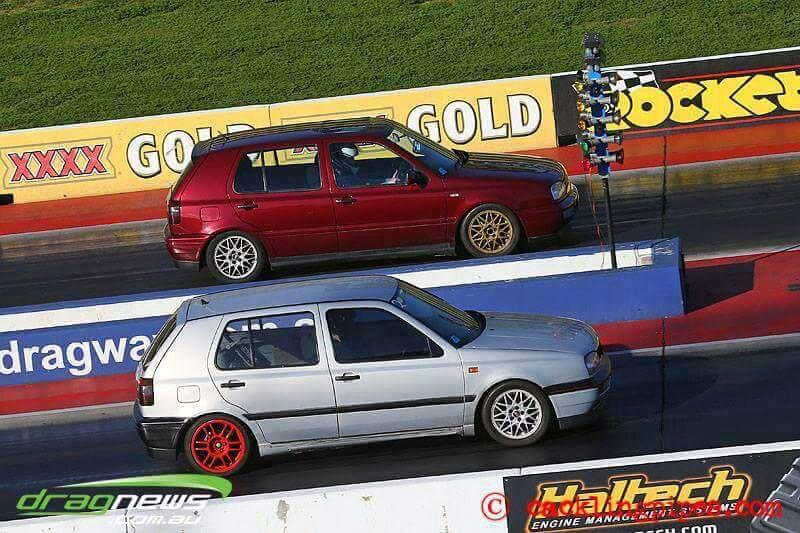

  • Fasted run of the day. Was also my first pass ever down a drag strip. Car definitely has a 14 in it, traction was a problem and so were poor launches. Does a mean single pegger though !

    • 205/50 drag radials are to small for even a standard ratio vr6
      Also vr6's are such a awesome car
      • Awesome!
        When you say the 205/50 are too small you mean in regards to contact patch or diameter for speed?

          Just not enough grip overall. Given our tires were about 8 years old that could have played a part. You could definitely go down in diameter on the stock vr diff ratio, i was at 6000ish in 3rd through the finish at 150.
          • I just baked them. Couldn't get traction regardless of burnout or launch.
            4th at 7kishrpm

                • holy fck thats great.
                  • Dude, you almost had me
                    • needs more vento with no brake callipers.
                      sick photo with the pair lined up.
                      Bora gone
                      Vento VR6
                      MKIV GSW TDI
                      7P Touareg TDI
                      • You could think that america for a second but then ya see XXXX!!!!

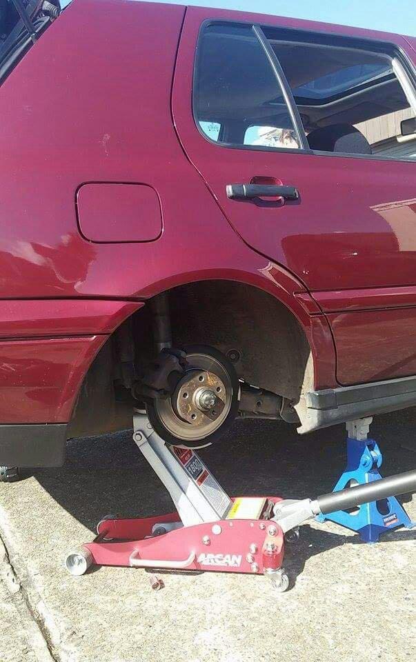

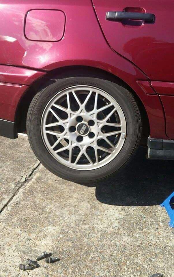

                              • Finally did something, installed new coils and found out why I had a savage front end knock. Ended up being loose strut tops on the front.
                                Got really scared halfway through the install, tyre was about a cm away from tucking unladed (In the air). All good on the ground though, finished photo is with the rears wound all the way up and fronts with 65mm of thread remaining.
