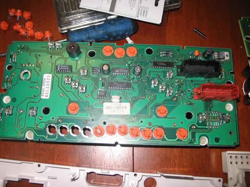

                  Let us know if Repco (or wherever you end up) stock the globes. For reference, they look like this (which is a cluster in pieces).
                  From memory the orange ones are 1.2W and are used for all globes EXCEPT the two that shine down onto the speedo and RPM dealies. Those two are grey and are 2W. They are Osram bulbs, or at least all mine are.

                    thanks for the pics Hawk, can I ask which ones are the ones that illuminate the dash? u said the grey ones? in the pic they have been removed, I assume its from the middle up the top?
                    cheers!
                      cheers!
                      Actually no. There are two gloves which light the guages. You do not need to unplug the cluster. Just unscrew the 2 screws on either side of the cluster, assuming you have taken the plastic surround off at this stage. I suggest using a magnetic screwdriver because you will (well I did) lose a screw down into the underpart of the dash. Once you have taken out those 2 screws grab the top of the cluster and bring it out towards you and down. On the top of the cluster you will see the 2 globes mounted on a white strip of plastic. If you cant undo them with your fingers (anti-clockwise) then use a pair of pincer pliers. Most of the time they are just loose or dirty and lose contact with the board. The part number is 47762 if the shop stocks NARVA items. I had to go to 3 auto places before I found them at an auto electrician.
