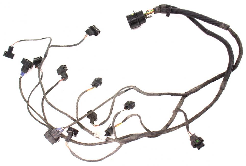

                • Complete fog light kit arrived. Scored myself one from a GTI.
                  Having trouble figuring out what the big blue plugs are for? They don't match the fogs.

                    • Originally posted by stefcio007 View Post
                      Photo? Might be for adjustable headlight motors.
                      • In this photo it's the plugs with the blue shielding on the cables next to the connector. They are bigger than all the other connectors.
                        *Ignore that it has the US headlight plugs. Other than that it's the same loom as I have.
                        Past - '95 VW Golf MK3 VR6
                        • Figured it out. They are used for the horns.
