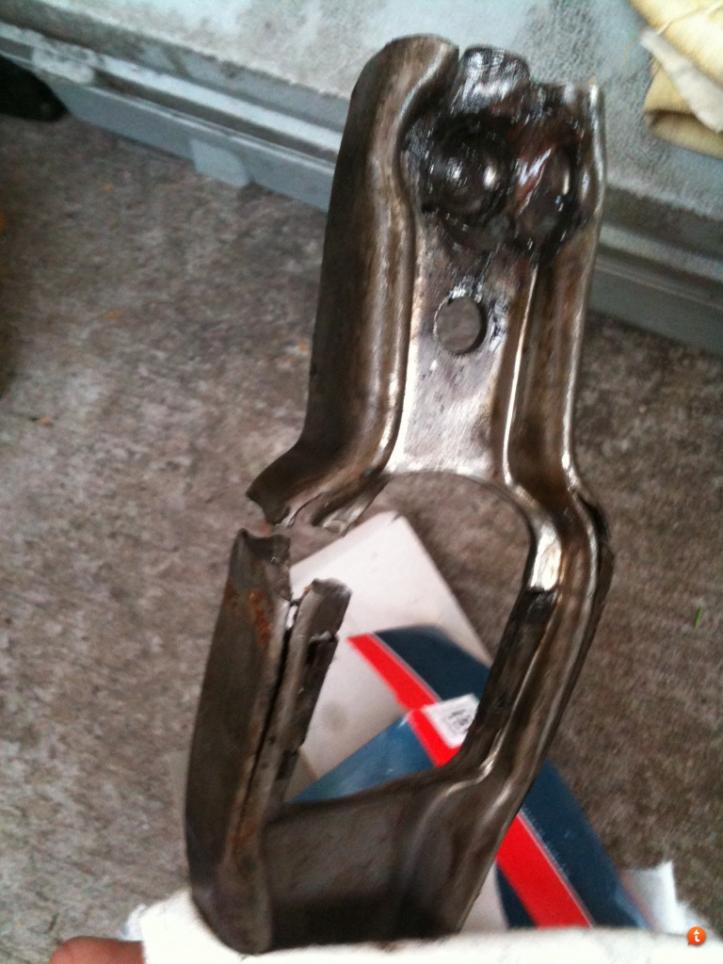

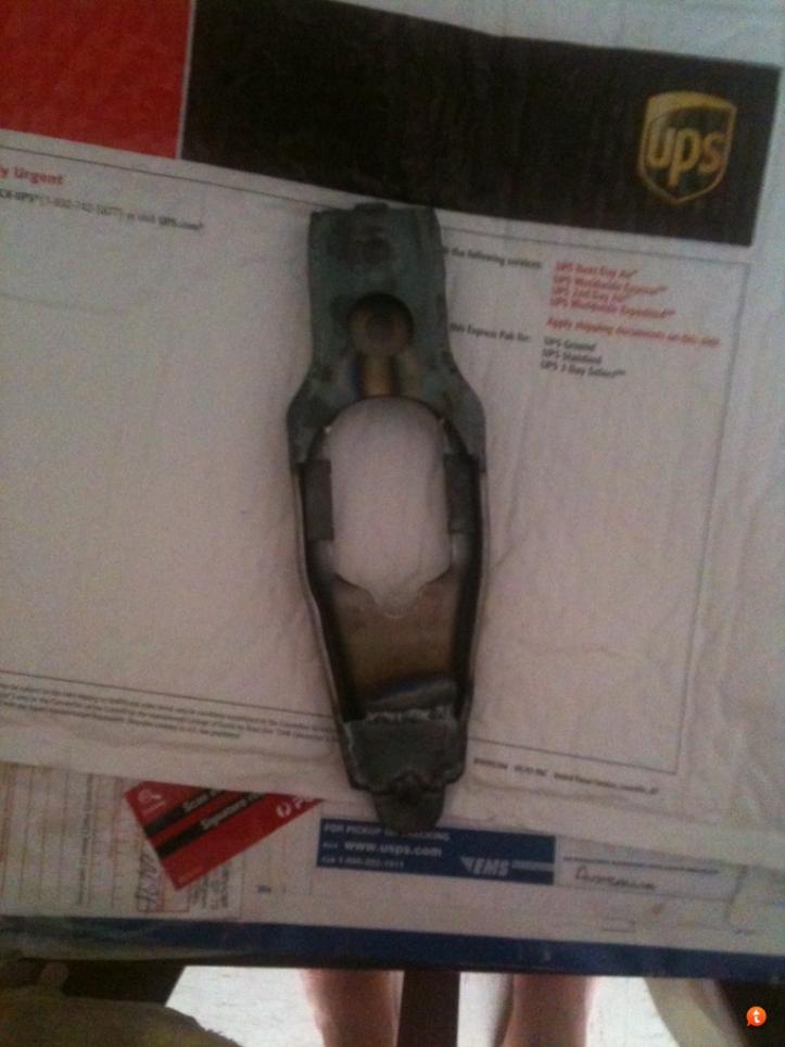

Clutch fork was the culprit. Snapped along the edges and in the middle (very similar to the above photo). Ruined the pressure plate and throwout bearing. Should be back together by Monday arvo with a new fork and oem LUK clutch kit. Not looking forward to the bill....Current: 2007 Black Magic GTI - APR Stage 2, Carbonio intake, APR downpipe and catback exhaust, RNS510, Bi-Xenons, Custom Red Leather Interior, Tow Bar, Racks and Parking Sensors
