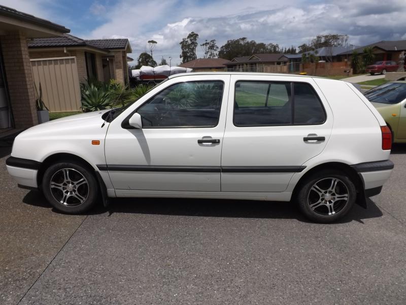

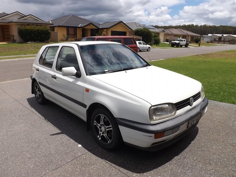

    Bought our first Golf a couple of weeks ago, a white 1994 2.0L GL 5 door, 300000kms. It joins our '72 beetle & '89 Caravelle.
    Seller did not bother to clean it at all prior to selling, covered in dirt, mud, no working brake lights, left hand blinkers, interior lights, area between bonnet / engine / windscreen, full of dirt, leaves, twigs. Interior absolutely filthy with dust & pet hair, tyres had about 15psi pressure in them, broken drivers side door lock, left hand rear power window regulator broken & glass held up with a piece of fencing wire that was twitched around the interior door handle. Front lip hanging half off.
    Got her for $900 with 5 months rego.
    Have already tackled a lot of these jobs, will post more as I progress through the tidy up.
    Pictures are after the first quick wash.

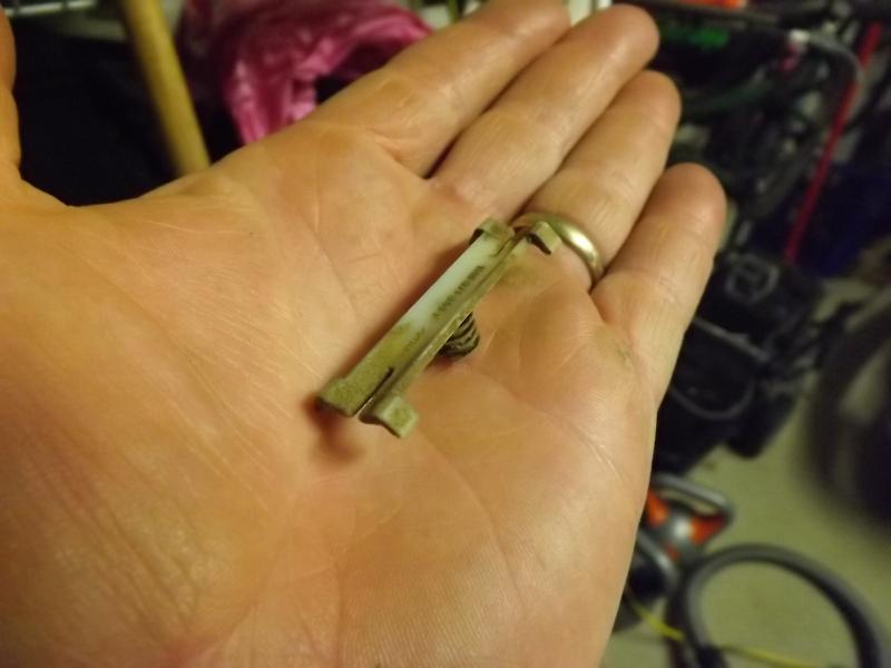

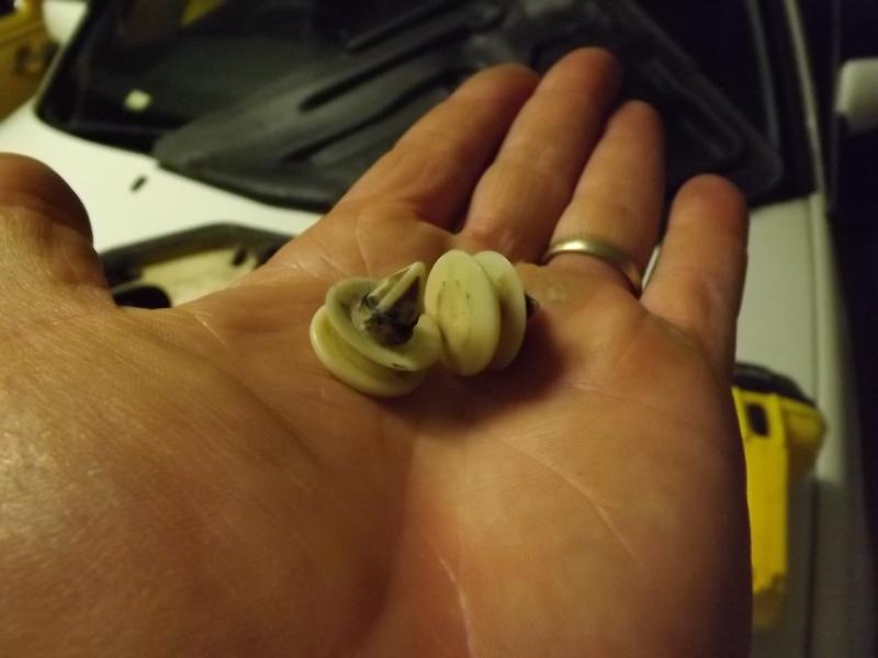

        Also found this in the bottom of the door, after I had already reassembled the window & regulator. Any ideas what it is off?

          re/ that first photo, no idea. Havent seen it before....

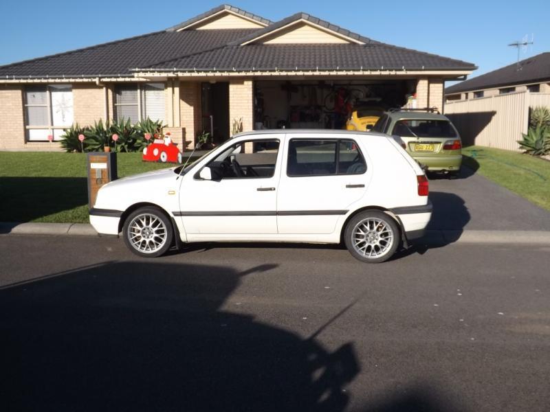

                    Not much happening at the moment, have just ordered a bundle of front suspension parts (bushes etc), so that will be the job over the Xmas break.
                    I have however swapped over the wheels tyres from our Pulsar (which will be sold shortly).
                    16" Speedy Hyperfangs, big improvement in my opinion.
                    The old 14" Advanti's have also dramatically altered the look of the old pulsar, not in a god way though

                      not sure about the clutch, however that first pic you posted up there of that thin long piece of plastic, they're wiring harness routers; the wiring harness is taped to them and they plug into a hole in the chassis/panel....
                          thanks for that, nothing majorly important then....... next time I have the door panel off I'll try & find where it goes.
