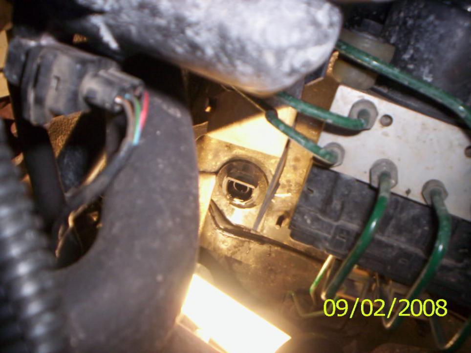

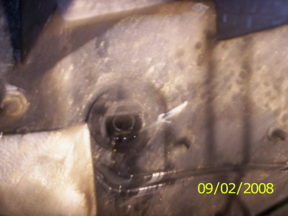

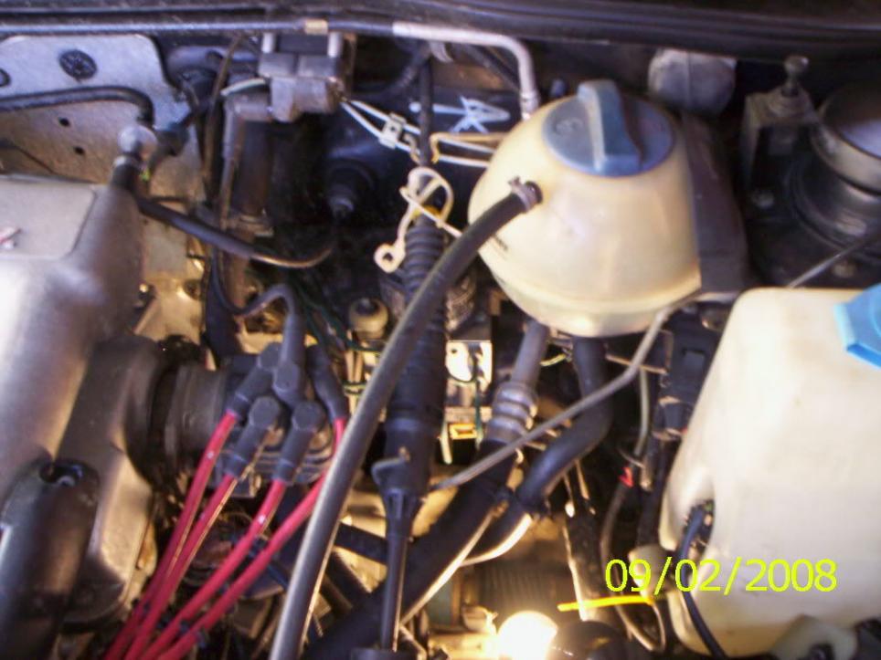

                  Ok I have taken a few photos of the water outlet from the air conditioning. These are of my Ibiza Cupra so they won't be exactly the same as a Mk 3 however the positioning is similar.
                  This is the passenger side under the bonnet. To the left behind the distributor and down towards the bottom of the firewall you should see this.
                  Here is a better picture.
