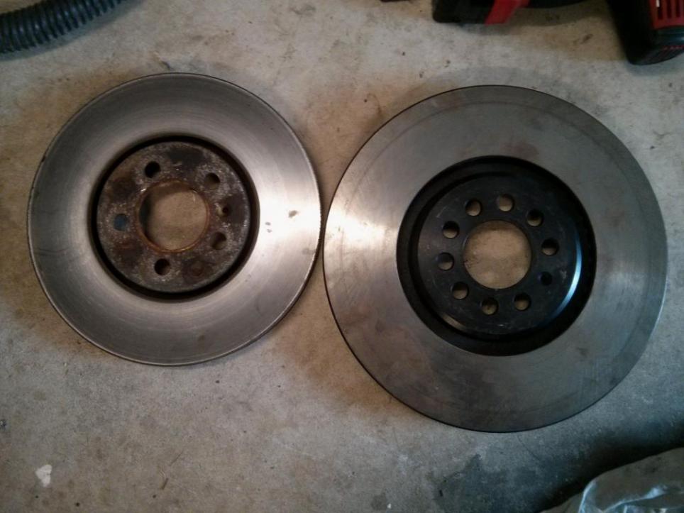

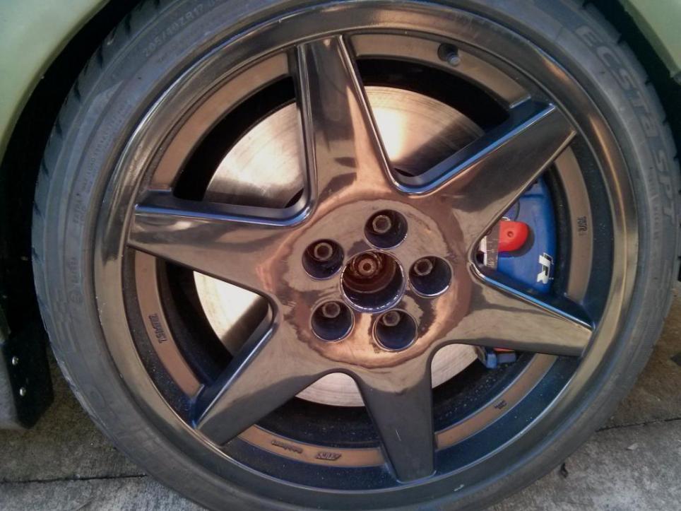

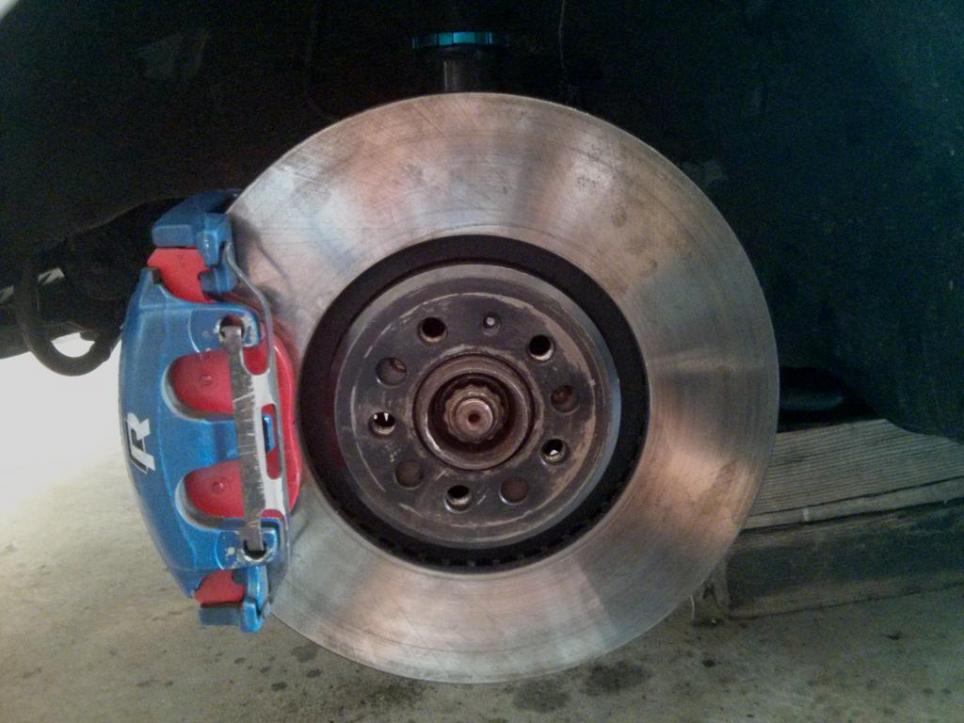

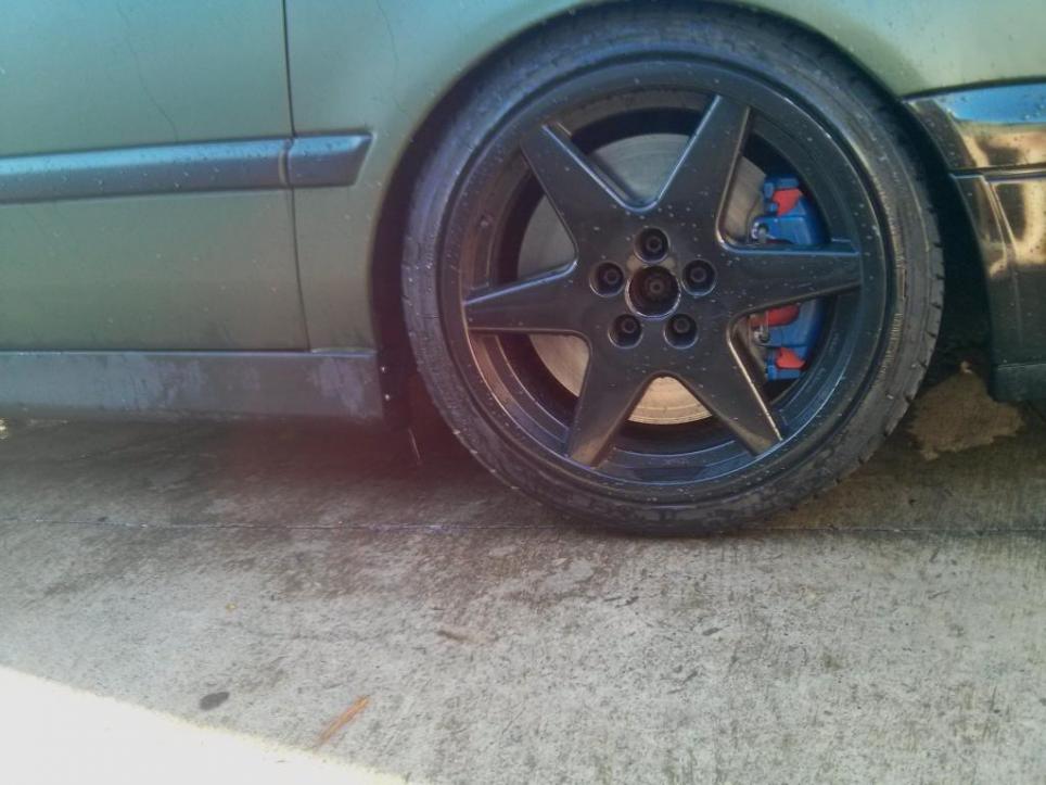

      Installed a MK4 R32 front brake setup today. Running plain rotors with EBC Redstuff pads, and a brake fluid flush and bleed. The car now stops with extreme urgency, I'm very happy with the upgrade.
      Old 288mm vs new 334mm discs:
      Had to file down the retaining clip a touch to clear the wheels but overall they fit well.
      • #33
        16"?

          No 17's. 16's won't fit haha.
          • #35
            mind giving us a full side on shot? want to see how the 17's look but damn, this is great man!
            how improved does the braking feel though? can you leave it to much later than the stock setup?

              You can leave it very late before a corner compared to stock definitely. The limiting factor is the grip of the tyres really. But when it does grip it is excellent. I think it's the pads more than anything.
