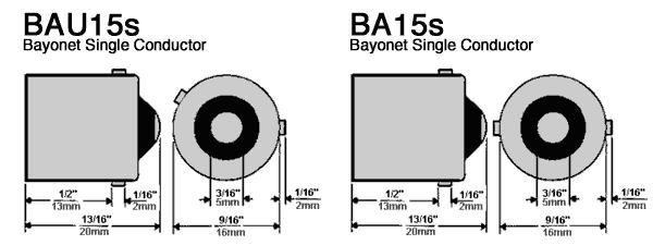

          • Just need to replace the front indicator bulbs to amber as i just got tinted lenses which don't have an amber insert.
            Which bulbs are these?
            Searched around and can't find anything and my existing clear bulbs don't say anything besides Narva 21W.
            Is it the BA15 or BAU15 fitting?
            thanks
            2010 Jetta 125TDi DSG
            1994 Golf VR6 Manual
            • Should be an Amber coloured 12V 21W BA15 which I believe is also known as a 12V 21W BAU15.
              1997 Golf CL, 2011 Caddy Life TDI, 2007 Golf TDI, 1996 Vento GL (red), 2008 Skoda Octavia TDI
              1996 Vento GL (white) - RIP
              • I just checked my clear front indicators and they have pins that are offset 180 degrees, so BA15.
                BAU15 has weirdly offset pins and I think those are used for the tail light indicator bulbs.
                Here's a handy chart.
                Past - '95 VW Golf MK3 VR6
                • Thanks stefcio! Your google-fu is superior to mine.
                  Definely Amber coloured 12V 21W BA15 then.
                  • awesome thanks guys!
                    didn't notice the slight angle difference with my (obviously) inferior google-fu
                    time to order some amber 21W BA15 then!
