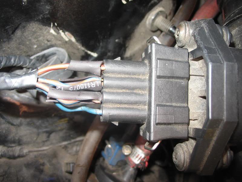

        Mine is doing something a little different, revs seem to be staying up. Also they don't seem to be dropping as quickly as they did. (mind you it seems to come and go a little).
        I kept thinking the MAF wiring, so I added a little heatshrink to seperate the wires where they were fraying, not perfect, but good enough for a job in the dark last night:
        Still happening... will look into it a little bit more and see what happens, any suggestions are welcome.
