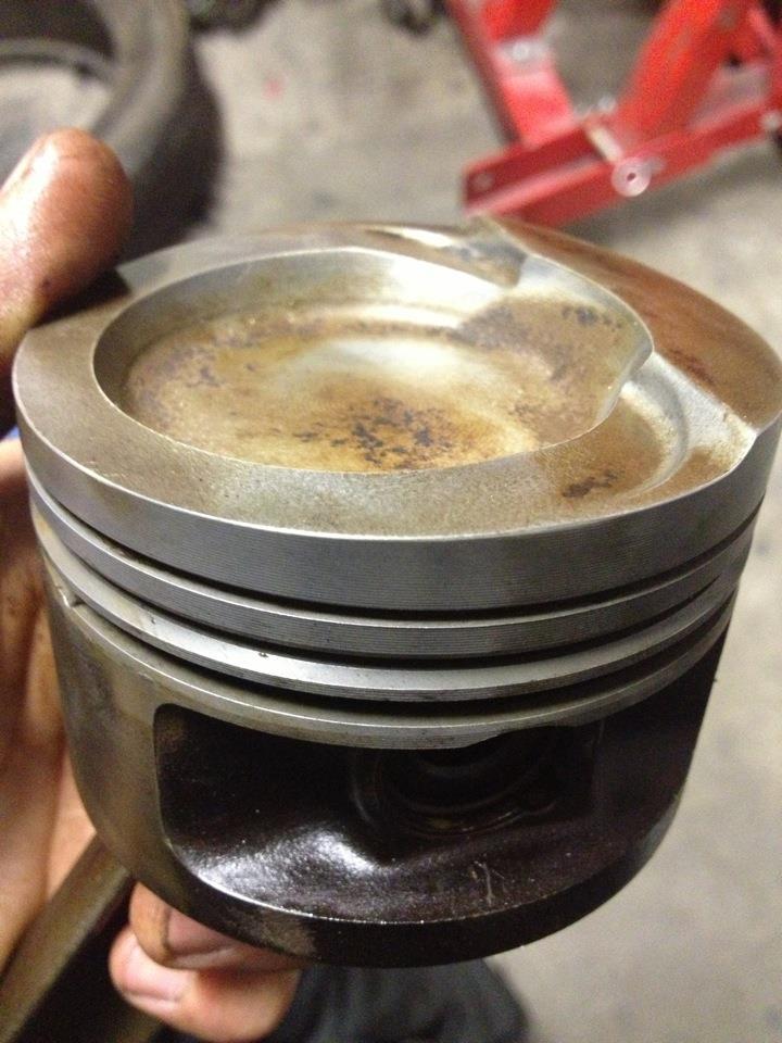

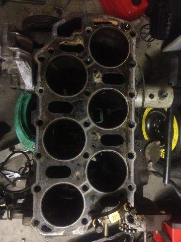

        Thanks for your inputs guys I dont think ill ever lose motivation its just my dad keeps nagging me about it telling that it not worth building it , but he cant talk guy used to own a 9sec Kjet gti so im just following his foot steps haha
        anyways i just ripped the pistons out of the block just before and the piston skirts , cylinder bores , conrods look absulutely fine but since im going forged pistons and rods my mum asked if I could make PISTON ASH TRAYS for her so why not , so ill get them chrome plated for the guests.

        and after recovering from the costs of above i will start on the block god this is going to cost allot awells its worth doing when its vr6 heres a pic of my dirty block and piston
        dont freak out this is after running it under a wire brush
