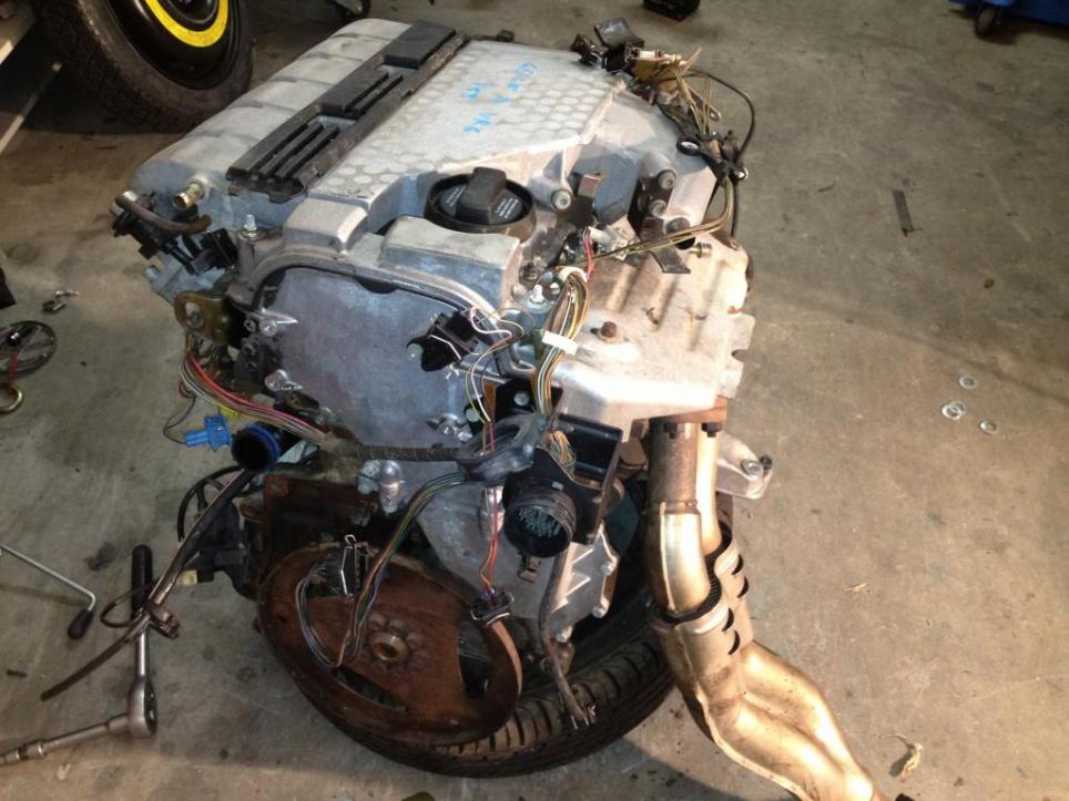

    Today 29/09/2012 1:30PM I was in a good mood so I decided to pick up the engine and bring it where it belongs
    Finally Look whose Home ready to be stripped naked I had enough of typing pictures will tell you the rest of the Story

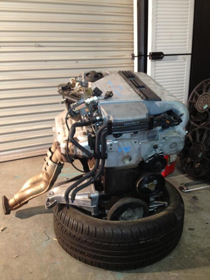

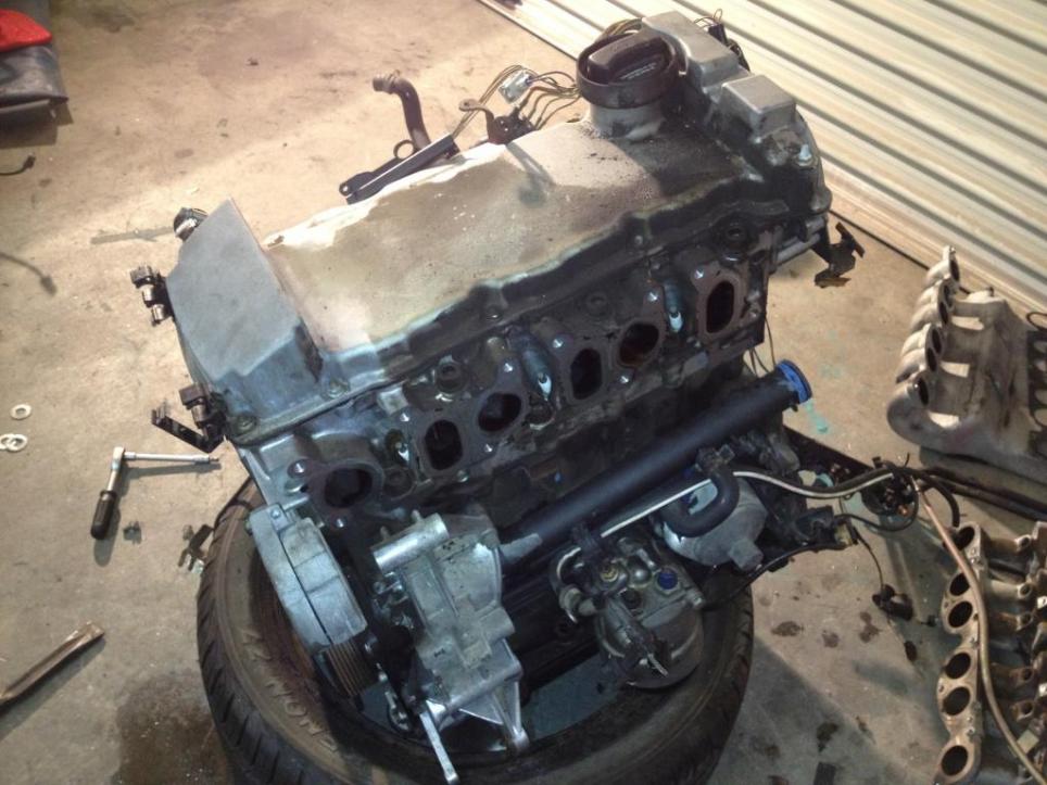

      So let the stripping BEGIN....
      Manifolds come OFF ..

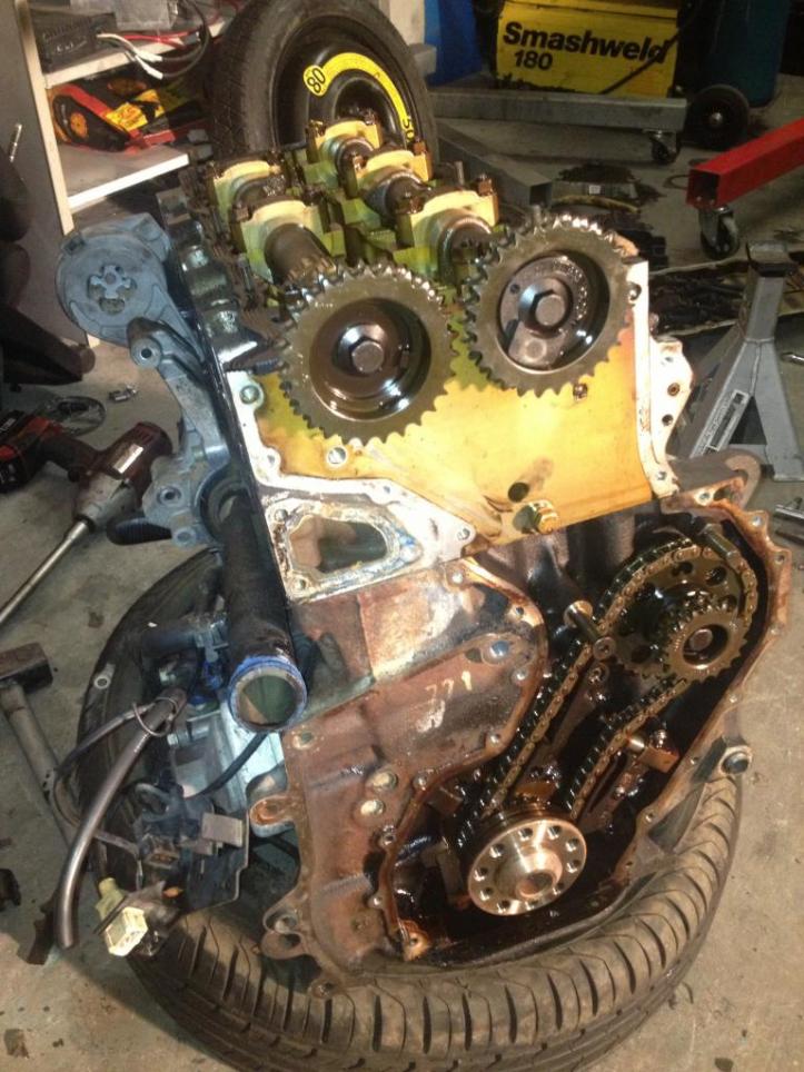

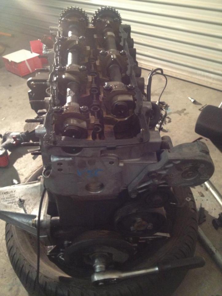

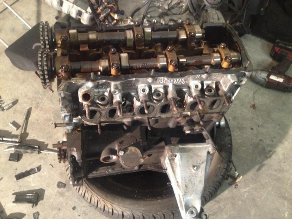

      Cam cover and timing chains come off (there were no guides just a few pieces hanging

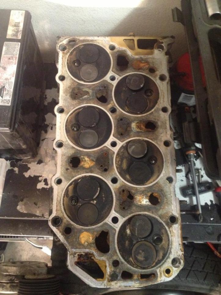

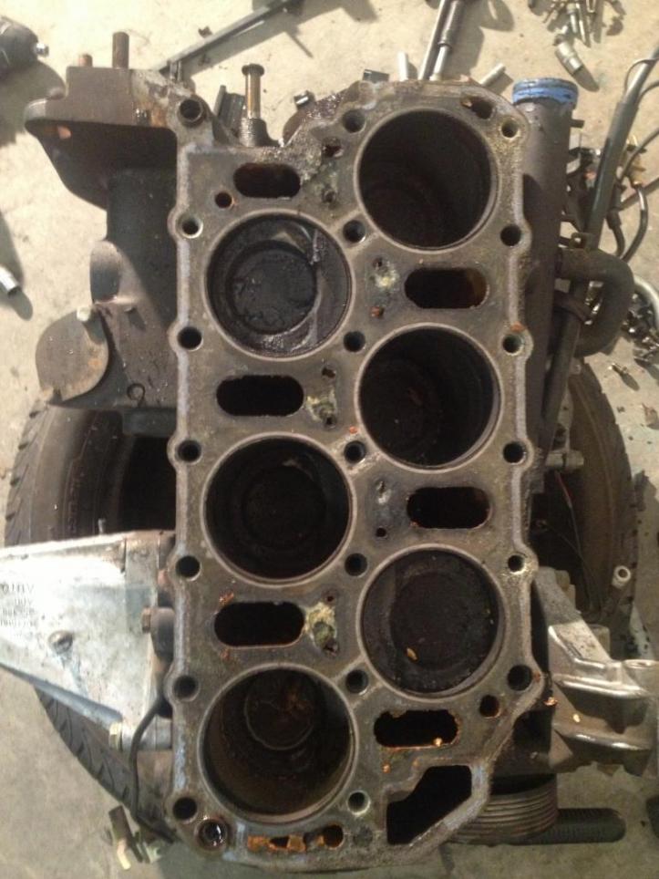

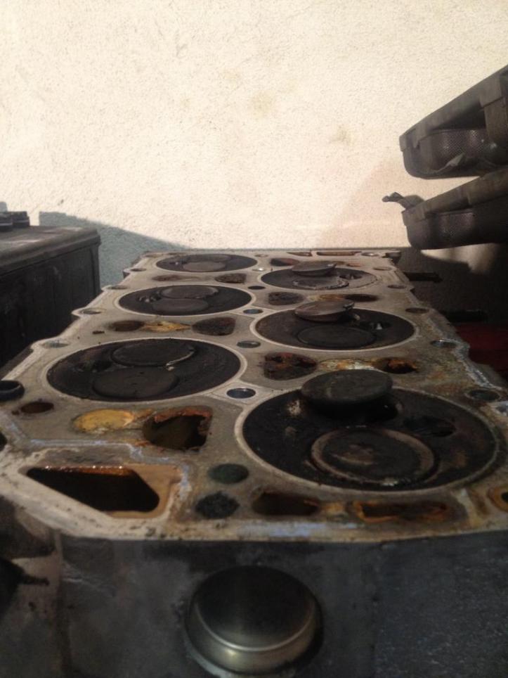

          Head comes off and we had bent valves awells were changing them anyway .SO THATS WHAT THE KNOCK WAS luckily there was no hole on the pistons. thats the first time i've ever seen bent valves in my life. so happy to be rebuilding a vr6 again but this time for power.But ive got another project drift car to finish off and then ill be starting to buy parts for the VR6. Im only on apprentice wages so money is hard to earn If your asking how long this engine will take to finish im guess until i get my full licence which is around 2 years so it will be a pretty slow build by saying that i still have to strengthen my 02A gearbox with stronger gears 3.94 r&p and LSD, driveshafts ,clutch,flywheel also a STANDALONE ECU .all of it will be in this thread . Feel free to comment and ask questions. Im still researching for parts and ways to build a power Vr6 . This car will be used for Street/track 1/4 mile purposes to teach those v8 boys a lesson
