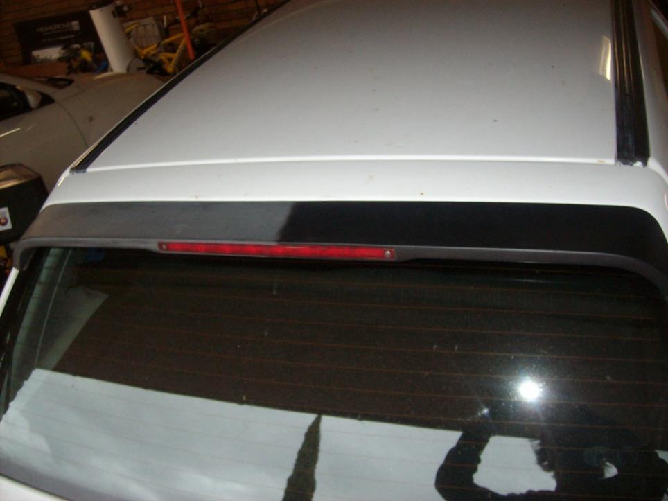

I wanted to try and see if heat gun helps restore some of it. If it doesn't, I'll go with forever black!

Go for a heat gun for the spoiler and the texture trim around the sides works better than anything else.. will make it look brand new again i did it to my spoiler the other day and i was amazed! best thing ever.. Dont use it on door handles though, just textured parts spoiler and front lip.

ok, i'm assuming that works by slightly melting the plastic?? i'd also assume you'd wanna be careful not to remove the texturing?? looks the goods though! Food for thought if mine fade out again....

I vote heat gun aswell, I did all my trim a few weeks ago and was the one who suggested it to a few other members on hereIt works really well. It doesnt melt the plastic or anything (just be carefull not to heat it too much) but apparently heating it up just gets the particles flowing in the plastic a bit, bringing the original non faded colour up to the top. I used forever black on my old car and it worked nicely too and lasted ages, but heat gun is my new favourite method now. Mine still looks really black, hasnt turned grey again yet.
Heres a 50/50 shot, about 1 minutes worth of heat on the right, untouched on the left:
