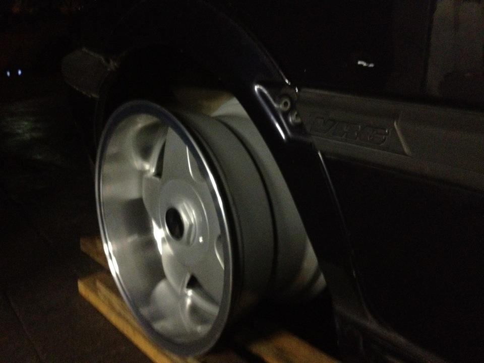

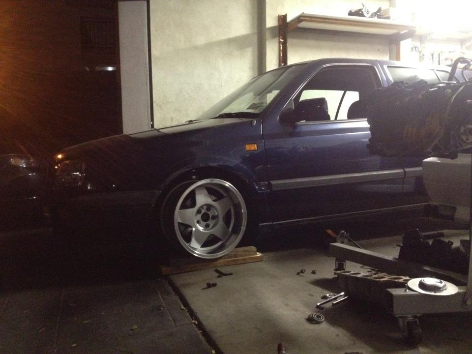

                          Here are some pics
                          Front are hanging with a few bolts |
                          Rears fit perfect !!
                          94' Golf Mk3 Vr6
                            How big of a spacer do you have? how much poke do you have?
                            A 205/40 is alot of stretch, especially for the front wheels, IMO.
                              If you're getting it resprayed then get your arches pulled and run a spacer on the rear.....?
