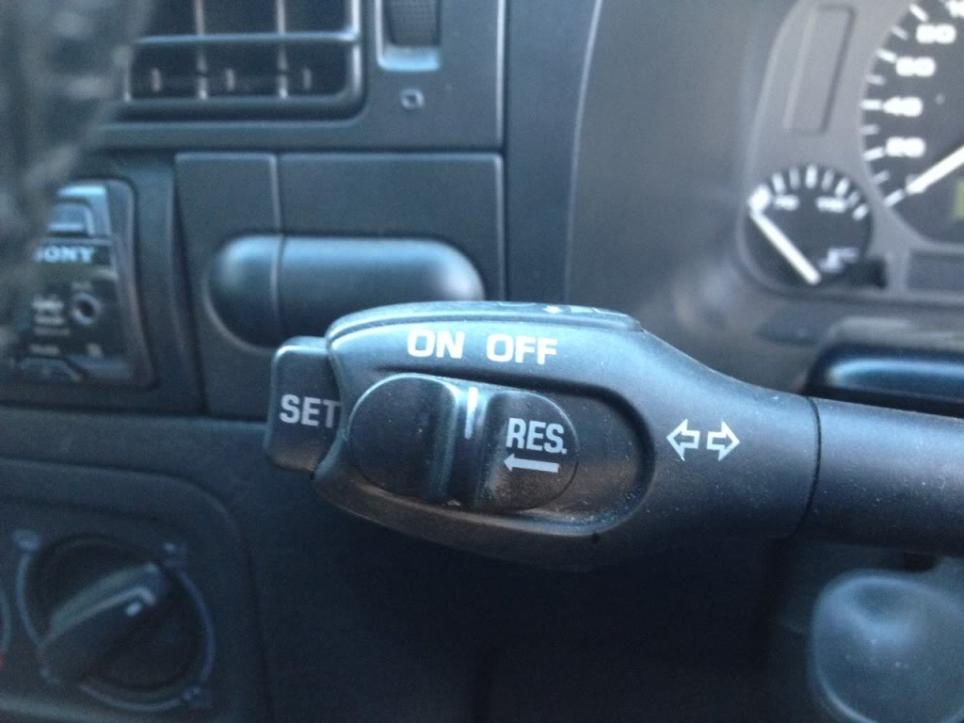

    Cruise Control

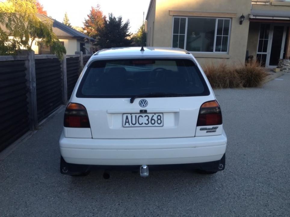

    Few pics of the standard car....

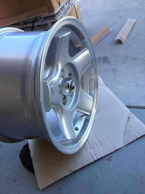

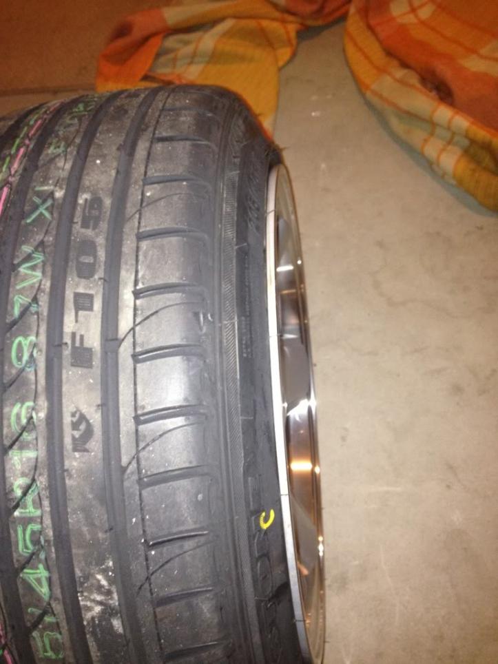

    New rims

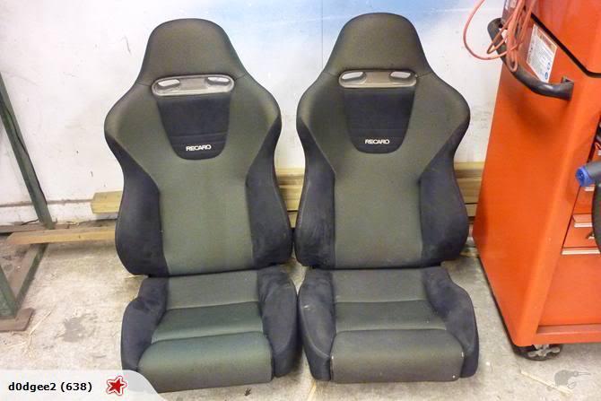

    Some Recaros purchased over the weekend

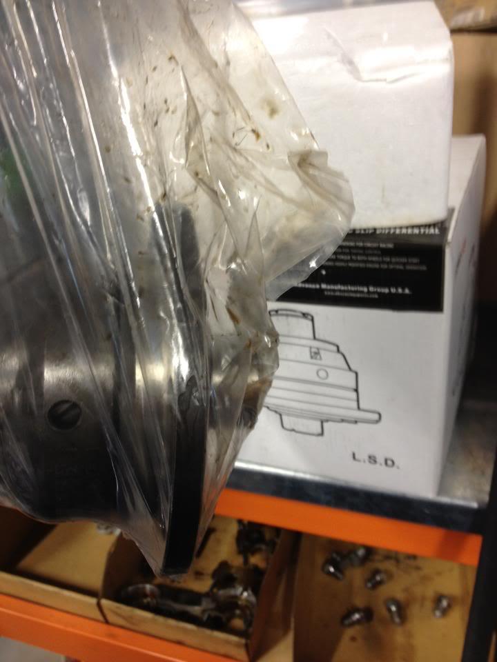

    LSD

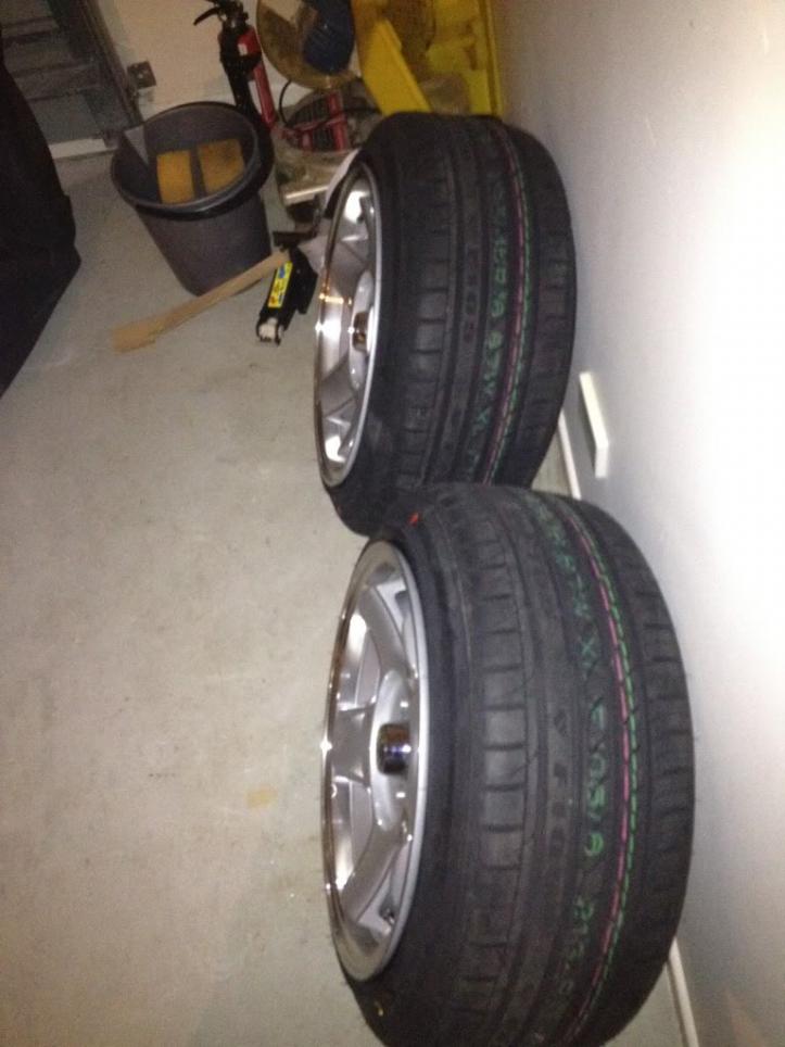

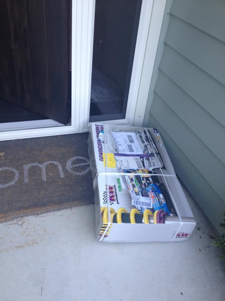

    Tyres are on; whiteline rear ARB ordered and full nolathane bushes kit ordered and picked up some Heavy Duty suspension top mounts

                I hope you got the later Peloquin diff as well . The early units are known the shear bolts . I dont know when Peloquin did the upgrade but it was common for the bolts to snap destroying the diff,gearbox housing etc and all you would get in return was a new set of bolts . Lately some people have received replacement later designed diffs .
                Lastly your gonna need a decent set of axles and or hubs , thats gonna be your weak link

                  im doing the bolts on the LSD as i know about the issues with snapping and destroying bolts which is feckin stupid really isnt it....bolt kits is worth dollars and cents but lsd is worth 1500! LOL
