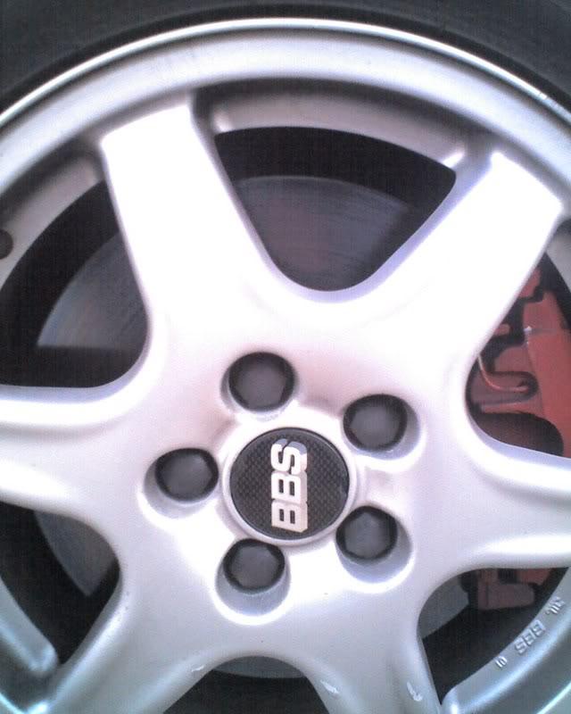

    Anyone elses brakes turn blue like this?
    They are accualy smoking in this photo, but you can't see it in the photo.
    Wat they are that what happening when your brakes dont cool down... U need som ducting... I wouldnt worry... Thats why racecars have a warm down lap to cool brakes and tryes etc...

      They pretty much always look like that. Idont normally stop straight after driving like that, but i did that time to take a photo. I figured its not doing anything bad, as my pedal still feels good, though i should probly replace the fluid. Get some DOT 5 in there.
      Also note, the brakes where not fading at this point!
        mate, that 'discolourisation' is basically what heat treated metal looks like...
        steel turns different colours as it heats up, blue means about 300 degrees, nothing to worry about, if anything it stops rust on your rotors as the blue colour forms a protective layer over the top of the steel

                  if you can get them glowing red hot (at around 700 degs off the top of my head).. well; I'll be impressed..
                    after blue a brown colour i believe but that would be a serious effort
