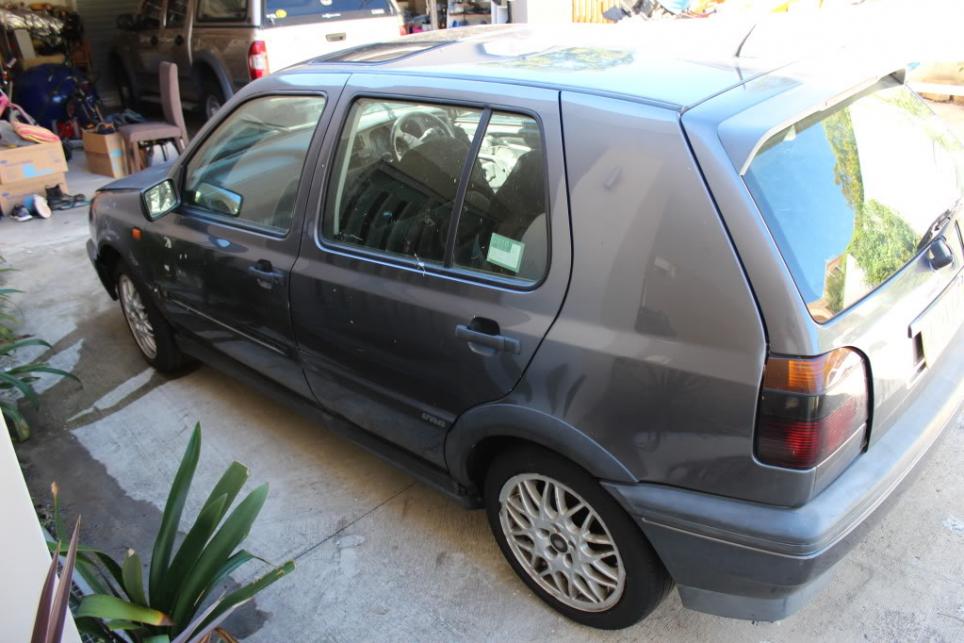

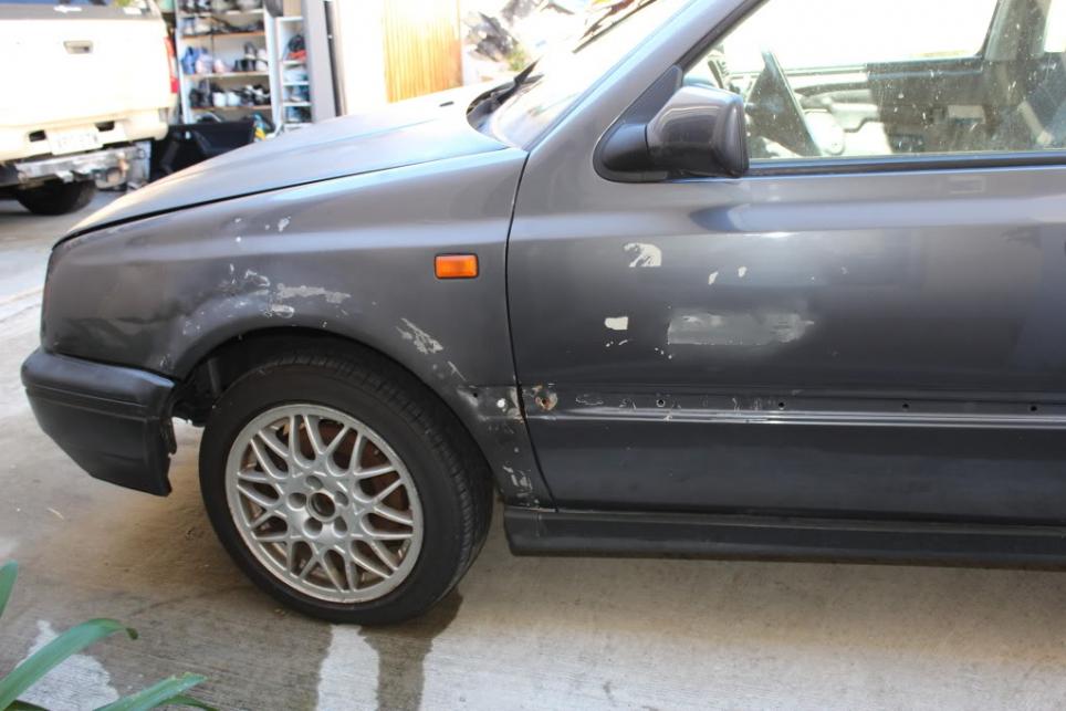

    Well it has been fun having my MK3 2.0 Golf but I thought it was time I had some VR POWER! Although my wallet kind of said no lol So I found myself a cheap and not so cheerful example of a 1994 VR6. It needs some work but that's the fun isn't it? My plan is to get the engine up and running, as it was sitting for a year at the previous owners home, then sort out the paintwork and interior. THEN the mods begin But of course the obligatory pics first, pretty much untouched at this stage so bear with me
    It has a few things that need to be done with the engine like the oil, coolant, leads, plugs and accessory belt as well as a split CV boot on the drivers side. And if I'm not mistaken pretty rusty brakes which I think are partially siezed, but then again I haven't turned it over yet so I can't really test it until I sort out those few things.

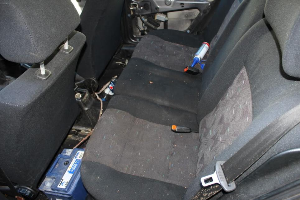

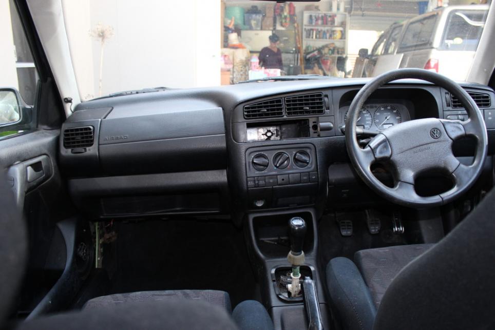

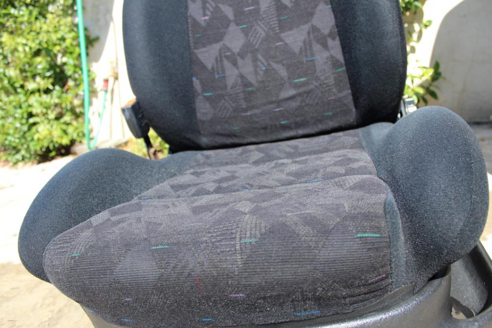

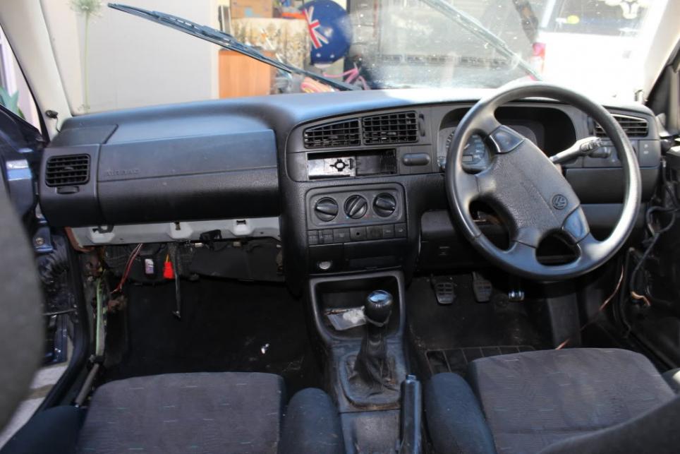

                      I so far have managed to clean up the interior quite a bit. Gave the seats and carpet a steam clean to remove the human slime and mold:

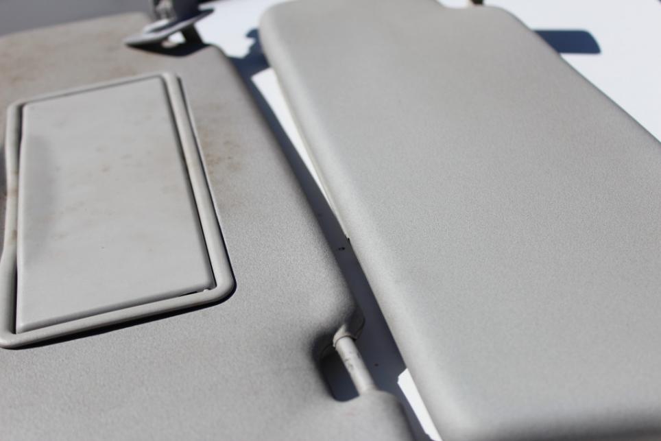

                      Plus gave the sun visors a clean too. Before/after shot. Must of had some pretty dirty hands whoever used them:

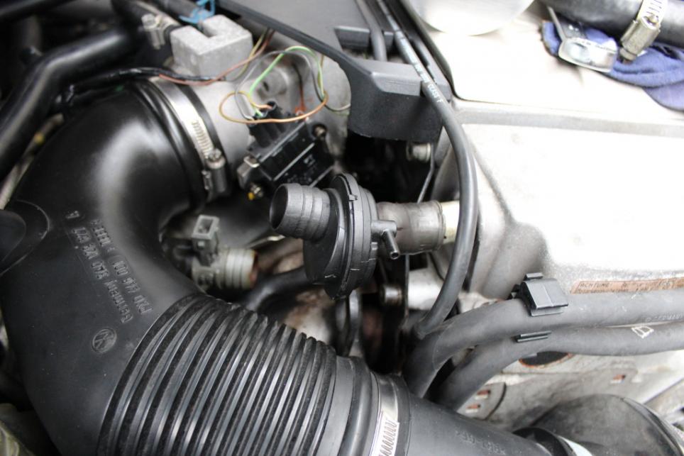

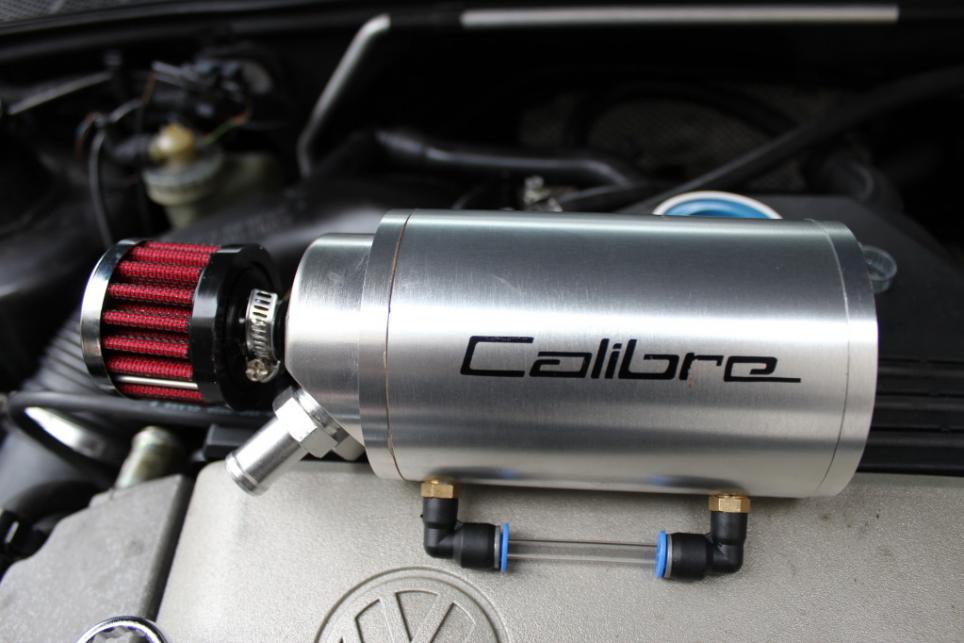

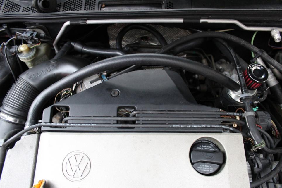

                      Then I installed an oil catch can because the PCV valve was well past it as well as the piping having a gaping hole and cracks all through it
                      Here is the old PCV valve:
                      And the new oil catch can I rigged up with supercheap parts
                      I just set it up to vent to the atmosphere for now until anyone tells me otherwise (blue slip perhaps?)

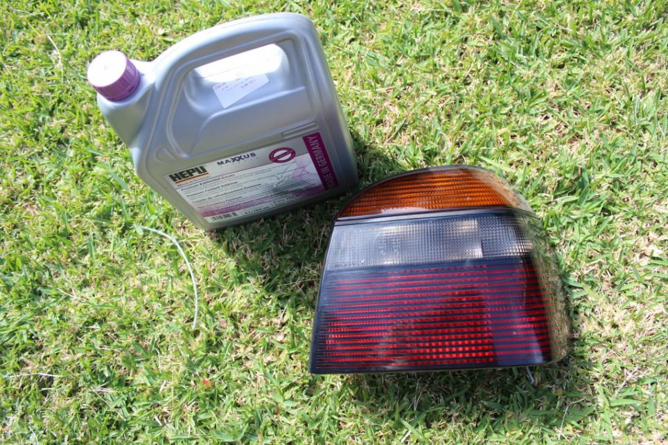

                      As well as these few things I visited Matt down at Camden GTI to grab an oil filter, G12+ coolant, a serpentine belt and a driver's side tail light (he didn't have a left one in stock haha )

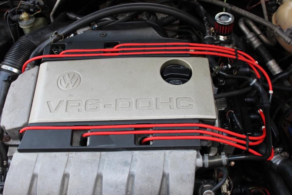

                      Then I changed the oil and filter, fuel filter and spark plugs/leads. Let me tell you that the oil filter was dirtiest thing I've ever seen and the oil itself was black as night, I was so disgusted I forgot to get a photo haha Anyway here's a photo of the new leads installed:

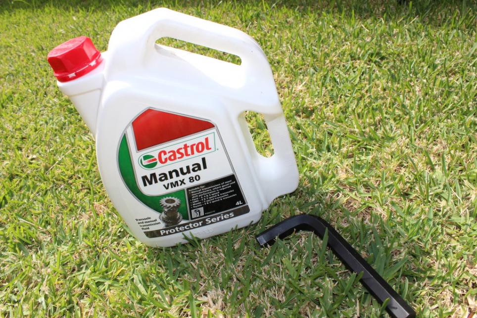

                      And finally I bought a 17mm allen key and some gearbox oil in preparation for a change. I've already done the 2L white golf just not the VR6 yet:
                      Here's a photo of the two together just for kicks:
