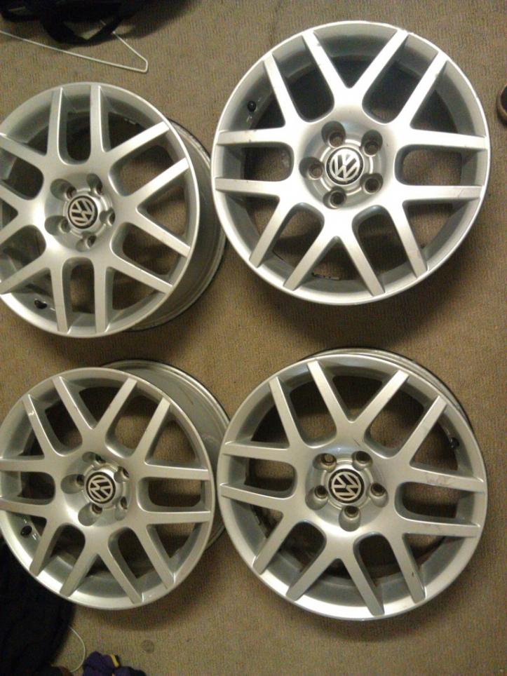

                  Thanks guys, it is super clean at the moment and no real mods planned so it will be pretty much untouched. Just a quick question on the wheels, I have found a set of 16's I like with an offset of 35mm, and I am pretty sure stock offset is 37mm, im fairly sure that these should work on stock brakes, anyone know otherwise?
                    stock offset is +43 15x6.5
                    really depends on the design of the wheel if it will clear your brakes
                    what type of wheel is it ? maybe one of the boys may be able to answer your question if you know what kind of wheel it is.
                    if in doubt its always best to test fit if possible

                      Ahh thanks for that, I am thinking of these at the moment http://www.ozracing.com/car_wheels_v...524/40386.aspx From tirerack.com 16 x 7 with a 35mm offset as I am having trouble finding wheels locally that aren't 18inch commodore wheels. I used the offset calculator and the result was 2mm more inside clearance and the wheels will sit 14mm wider than current wheels which seems good given the wider rims
                        that fitment will suit perfectly.
                        you should be able to ask them about brake clearance. they' should be able to give you some specs for it, and you can jack her up and just drop off a front wheel and measure it all out.

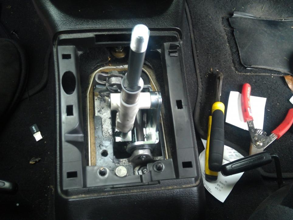

                            So small update, I have installed a short shifter and just go these wheels, so hopefully will get them cleaned up and tyres put on them soon, and then I will chuck up some updated whole shots!
