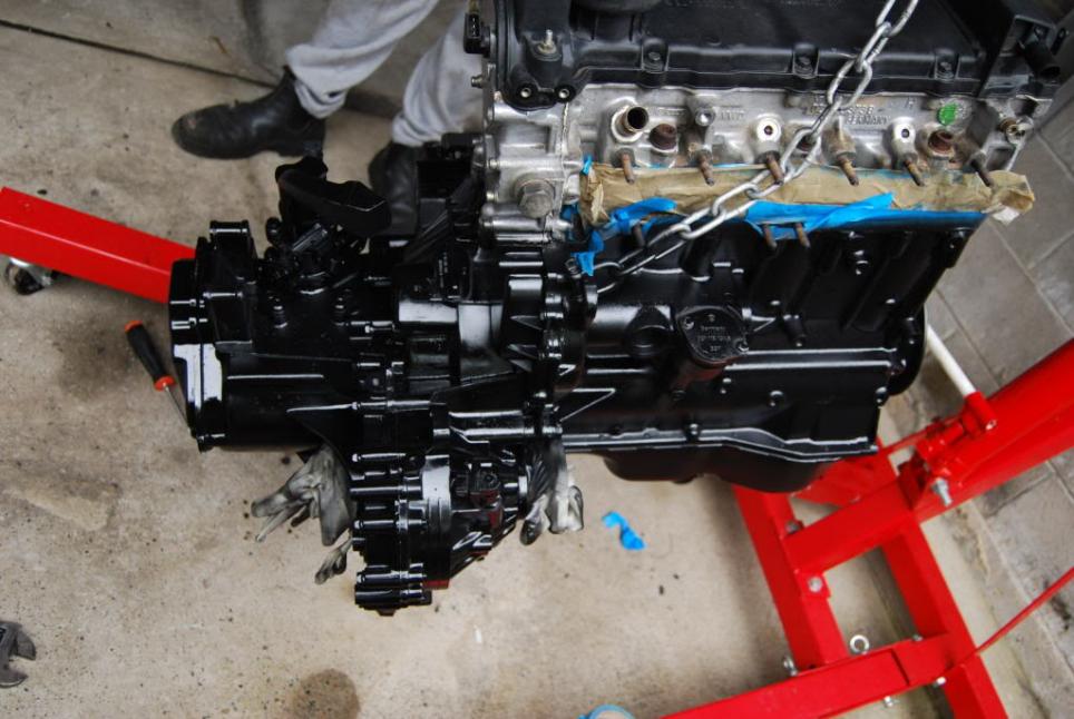

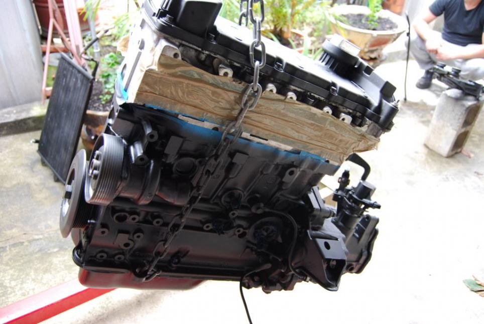

    Cleaned the engine a little and what I had done came out pretty good.
    Exhaust manifolds are done and I will be taking the heat shied off to show them look quite good I think.
    And the engine bay which is clean and I am happy with it now.

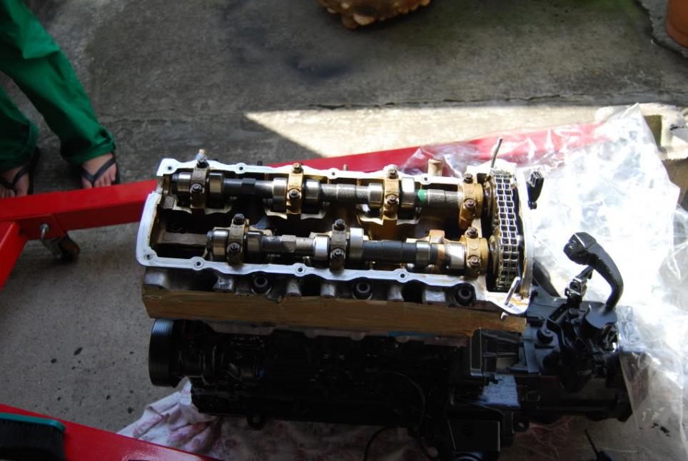

    But this is why I have taken the engine out to do timing chains cause someone had ****ed it up previously..

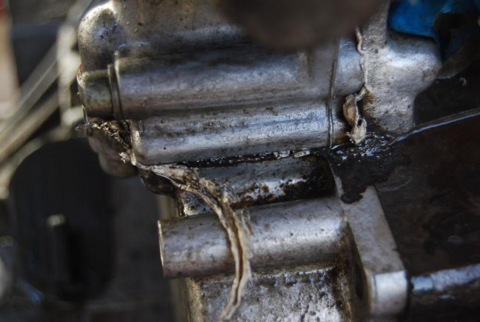

      • Hahaha someone's silasticed the cover back on! Use a proper gasket or don't attempt it yourself. It's that simple.
        Gees you're anal, Steve. Looking gooooood.
          We didn't actually use a gasket for mine, as it doesn't have one. The instructions I followed said just to line the edges with new oil
          • I'm pretty sure your meant to use a compound for that but obviously not here.
            • isnt that part where the head gasket is sandwiched between the two sections of the timing chain cover? To fix that properly you might be up for a new head gasket? Its a silly design really

              • Hey Steve,
                Have a look at these threads.
                Looks like they replaced the head gasket at the same time they did the chains.
                The guy that did your chains was probably trying to save you money, cause changing the head gasket isn't cheap on a VR6.

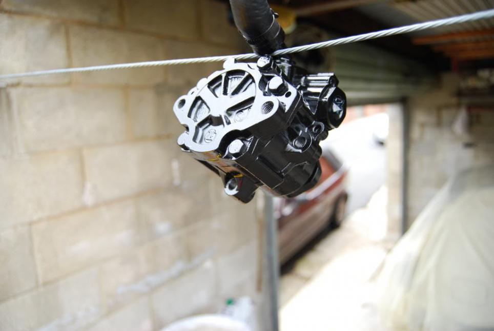

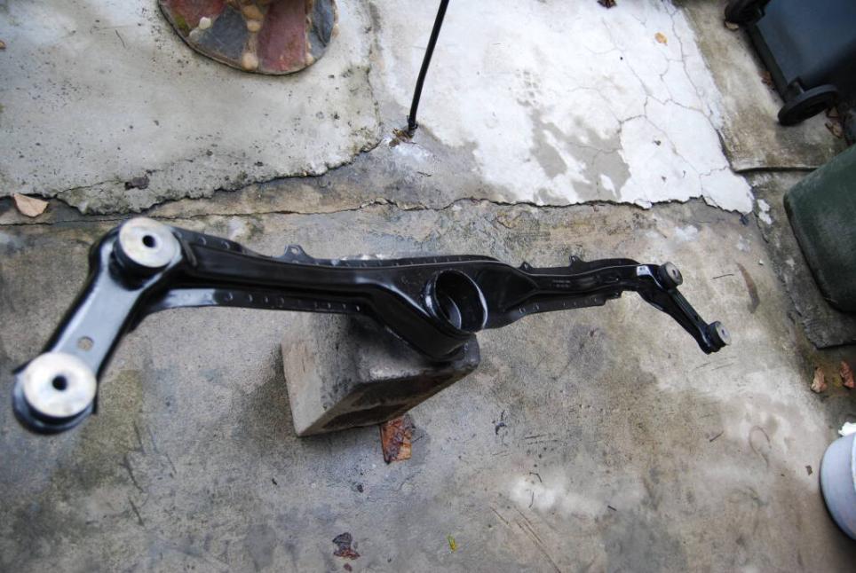

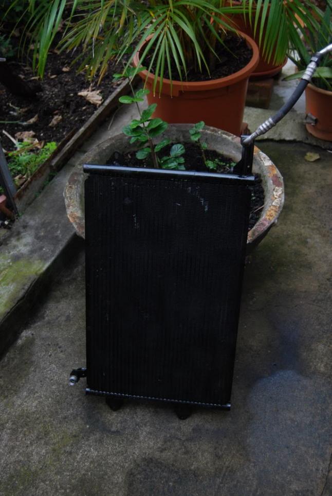

                    • Subframe repainted.
                      Condensor blackened.
                      Power steering pump, no one is going to see it but I'm not leaving things half arsed!

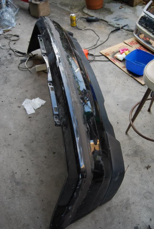

                      Rear bumper done just needs high fill and off to the painters it goes!
                      • Looking good Steve, what type of paint did you use on the bits you painted?
                            Engine was a basecoat of satin black caliper/ brake spray, and then engine manifold gloss black spray. Due to the caliper spray being a igher temp we applied that first.

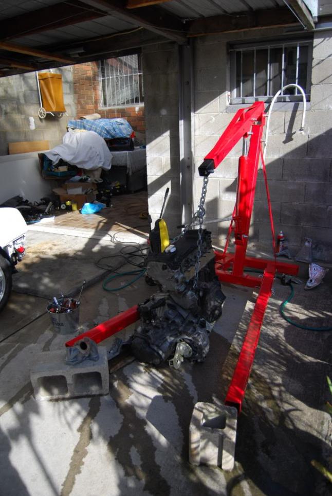

                            • What the engine out of car?? I didn't know that, gearbox off is easy now!!

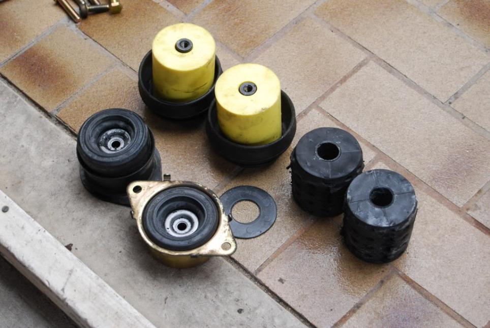

                                By the way, what engine mounts are you using?
