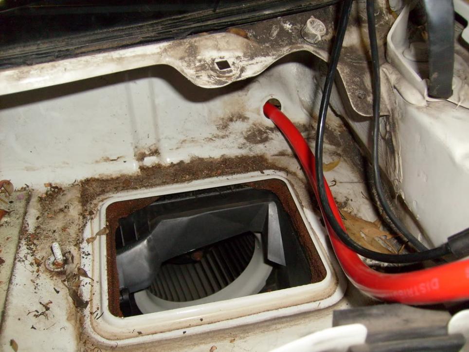

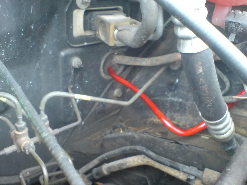

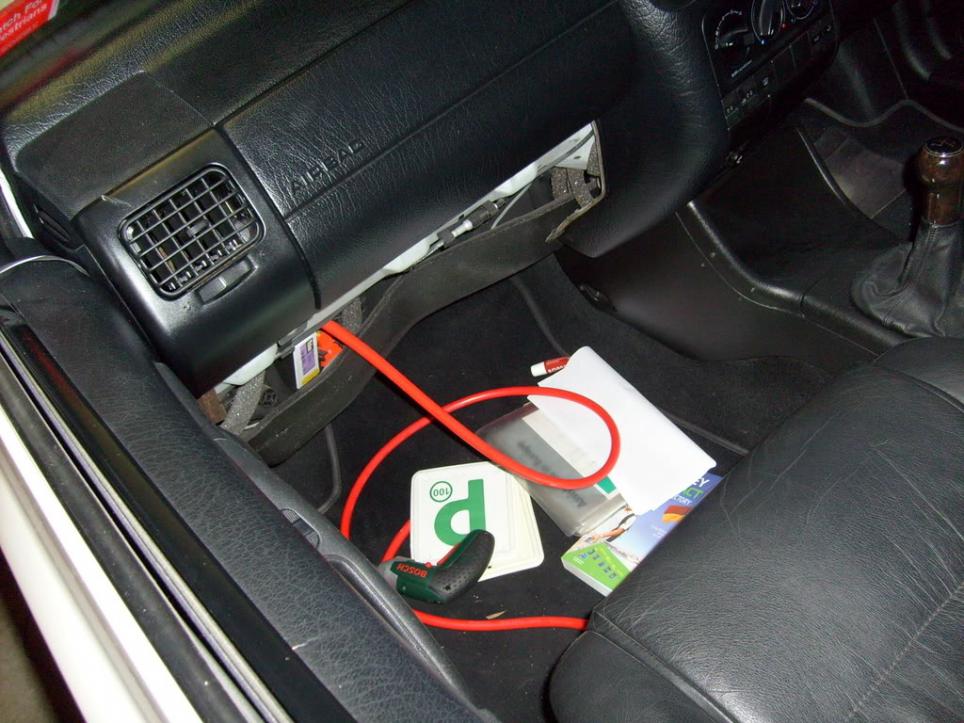

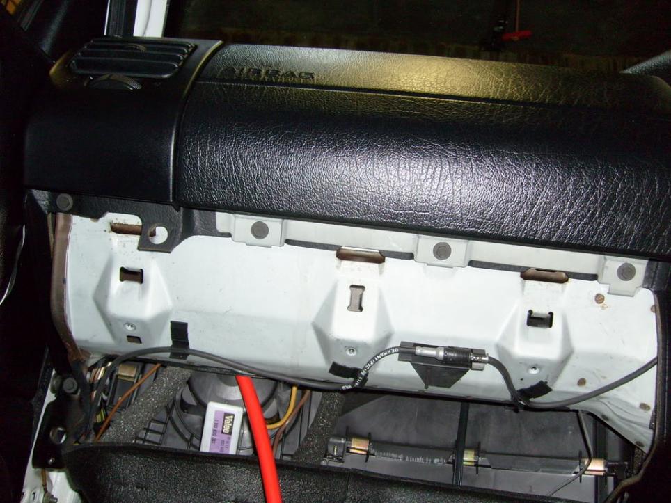

      So Thursday night I got tinkering with the things that I wanted to do before I sent it to Detroit Customs, so I wanted to start on the battery relocation. The hardest part was going to be trying to find a hole that will allow me feed through the 2 guage wire from the engine bay through to the boot entirely throughout the inside of the car! This is pretty much as far as I got! But it took me 45 mins to work out where it was going to go in the end....
      Found a opening behind the glovebox which I took off to feed it through
      Under zee raintray That hole was already there and had a small plug that went over it!

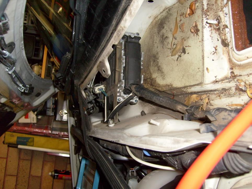

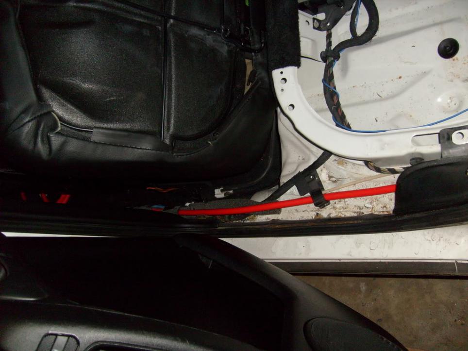

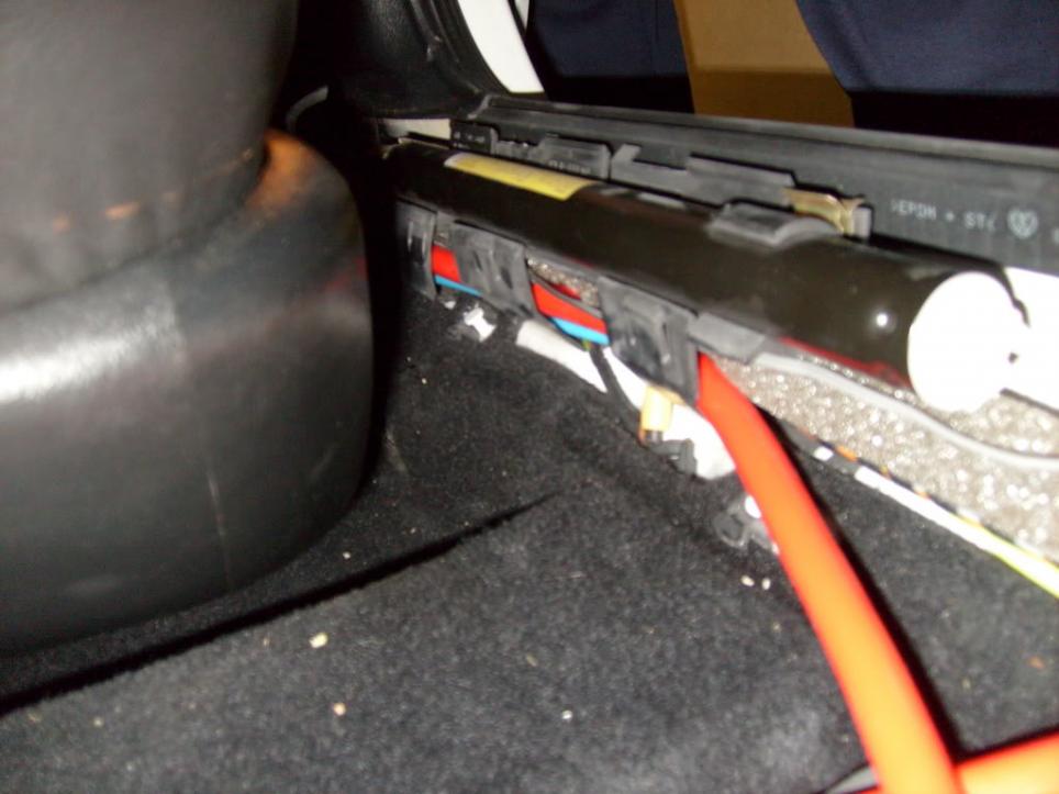

      Opened up the side and fed it through there.
      Through to the back, and then left it in the state its in lol.

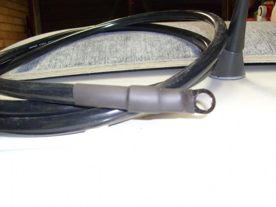

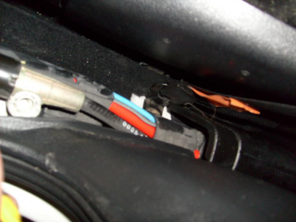

      I then made the connections and left it there this is a example which is the negative 2 guage cable, quality I thought!

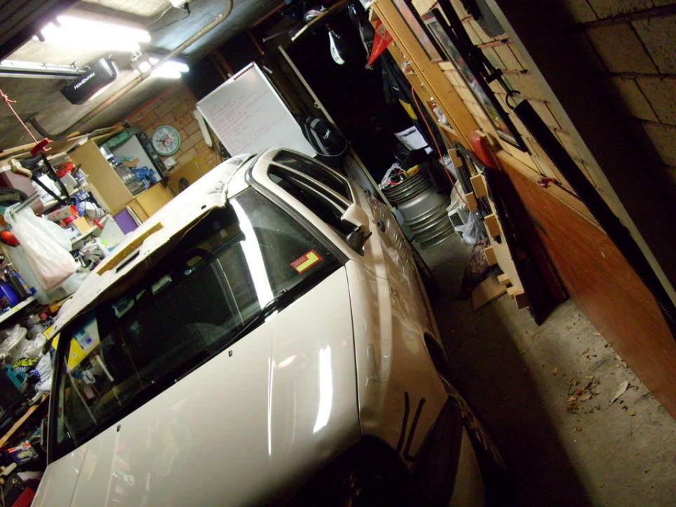

        The clutter of the garage my dads garage is getting swollowed up by my stuff hehehe!

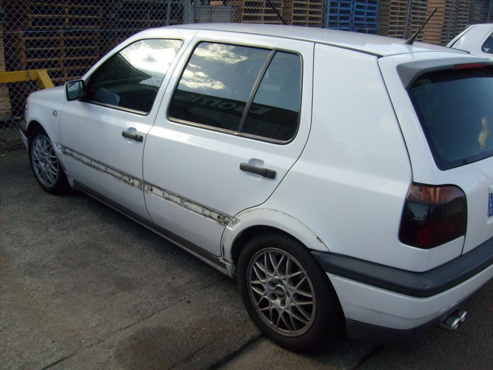

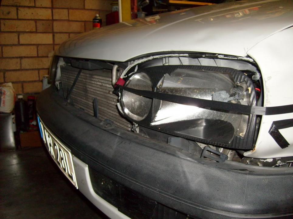

        The damage in all its glory.

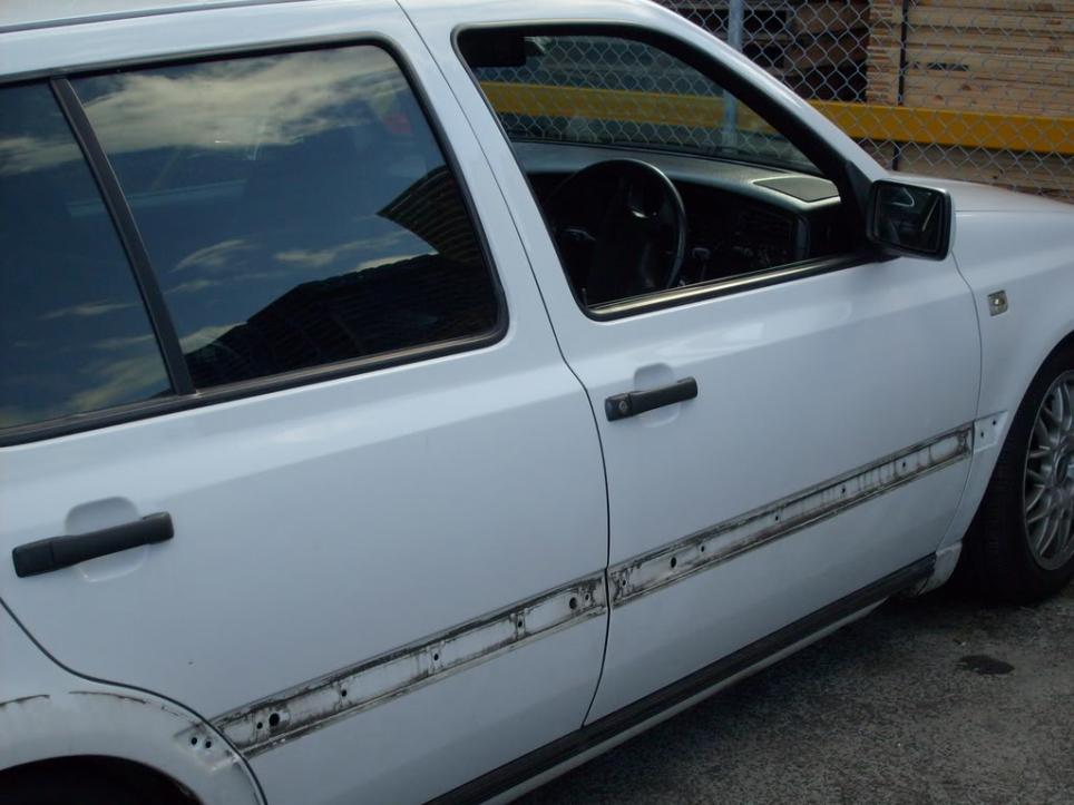

        Friday awaiting its makeover

              • did you know there is a big fat rubber grommet that goes straight into the cabin behind the glovebox? drill a hole slightly smaller than the cable (like 1-2mm smaller) and poke it through! Here is a pic:
                My cable is 4ga for the Amp i just bought
                The part where it comes out is really easily accessible and then it makes it easy to guide the cable down under the side skirts where you already have it.

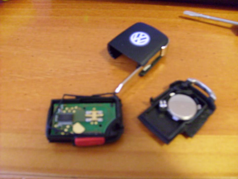

                          • Interesting there Aaron in regards to that. However I will not superglue it to the inside of the shroud. I am actually going to hide the chip in the actual key fob. Theoretically where I put it, it shall work, however theoretically speaking I will also need to use a dremel to channel a little hole through it for inside. I have actually thought of a few different ways but I the one that will make that chip secure is actually opening the whole key fob and inserting it in the key itself
                            • Any key cutter can do the, er, key cutting - you just have to remove the key from the fob. The bulkiness obstructs the key cutting machine otherwise. You'll be able to open doors and the hatch, but everytime you try and start the car, it'll fire up but will stall straight after as it doesn't recognise any chip.

                              • Yeah Ray, my problem is trying to get the key out of the fob how did you do that?
