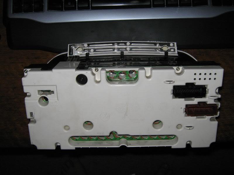

            At the back of the cluster at the top there are two bulbs:
            See the holes here:
            They are 2 x 2W bulbs (where the rest are 1.1W) that light up the speedo and tacho. It's common for people to use the 1.1W instead of the 2W bulbs which are then no where near as bright. You could hack it up and put in some LED's, something I was considering, but in the end I went the lazy way
