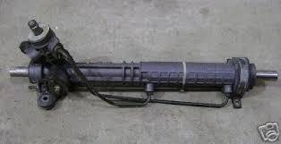

      • can any one confirm what steering rack I should have in my vento?
        quick search shows the ZF rack has a square waffle finish like this:
        and the TRW is smooth. mine appears to be smooth (TRW), just want to double check its the original part etc, is there anywhere to look up a list of what years/models came with what?

        • Alllllll the same

            what you mean? all aussie are TRW? because im buying bits from ECS and makes a difference to what I buy in regards to tie rods and things...

            • This has got me pretty confused before too. I think it should be a TRW but I cant be 100% sure. If your's isnt waffely like in that picture then yes Im under the impression its a TRW

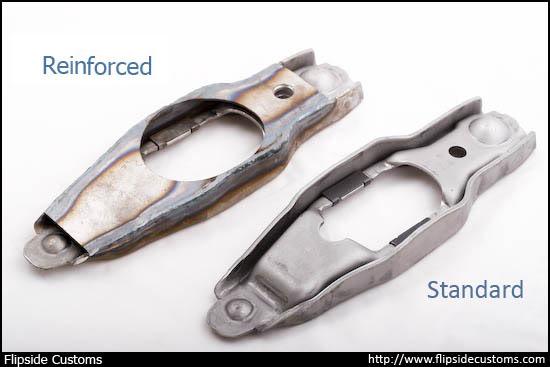

                  • did some more interneting/googling and less work on the car...
                    I came across this. maybe the source of my dodgy feeling clutch, apparnelty a problem when upgraded clutches are installed, and Tim pointed out this car already had a problem with the fork not long after the clutch was originally installed.
                    Refer the bend...
                    if that is the case, plan is to either buy or make this (pending on the cost of a stock unit...):
                    Will suss out if that is the problem when its all out, as Josh pointed out might be worth while strengthening it anyway!

                      • not to worry Dylan changing gears on a VR is like rowing a boat, you can adjust the linkage for a better more direct feel but then that can only take things so far.
                        clutch forks even new from the stealer ship are less then $50 the last time i checked.
                        02j shifter tower conversion is the way to go if you want the VR to shift like a mk4

                          oh nice. the strengthened ones are $90 before postage. so probably better off just buying a stock one and beefing it up
