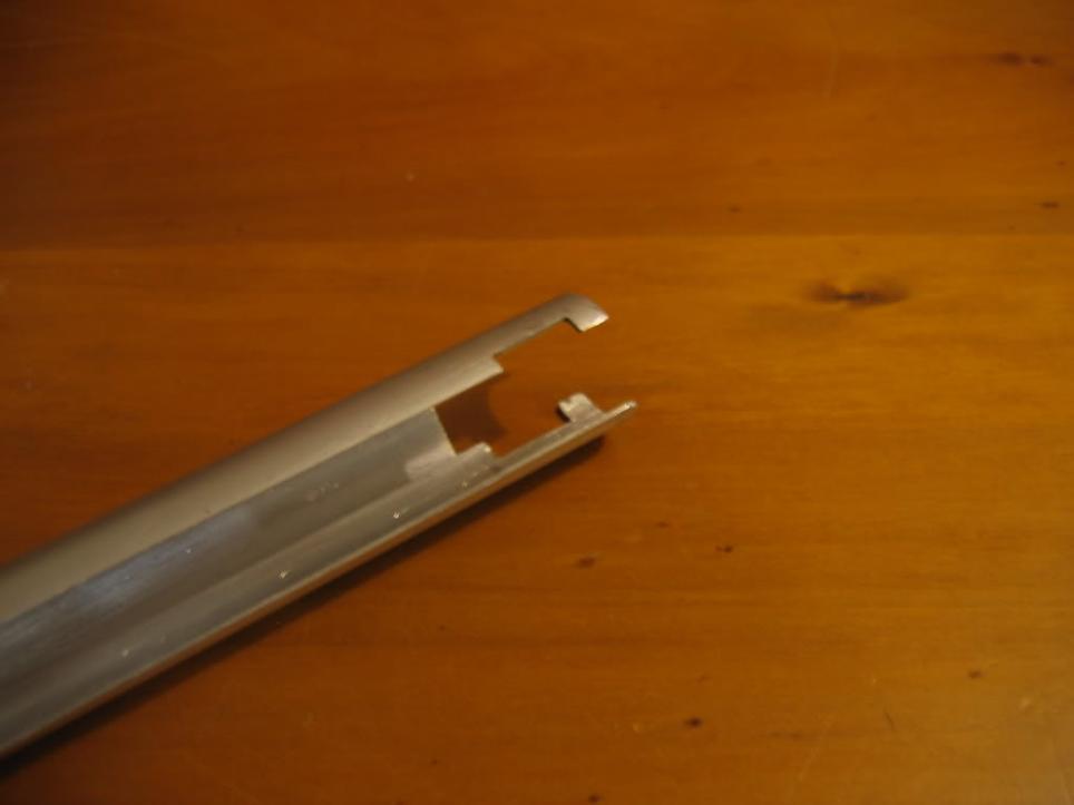

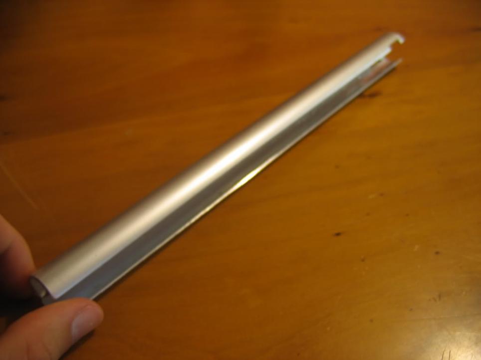

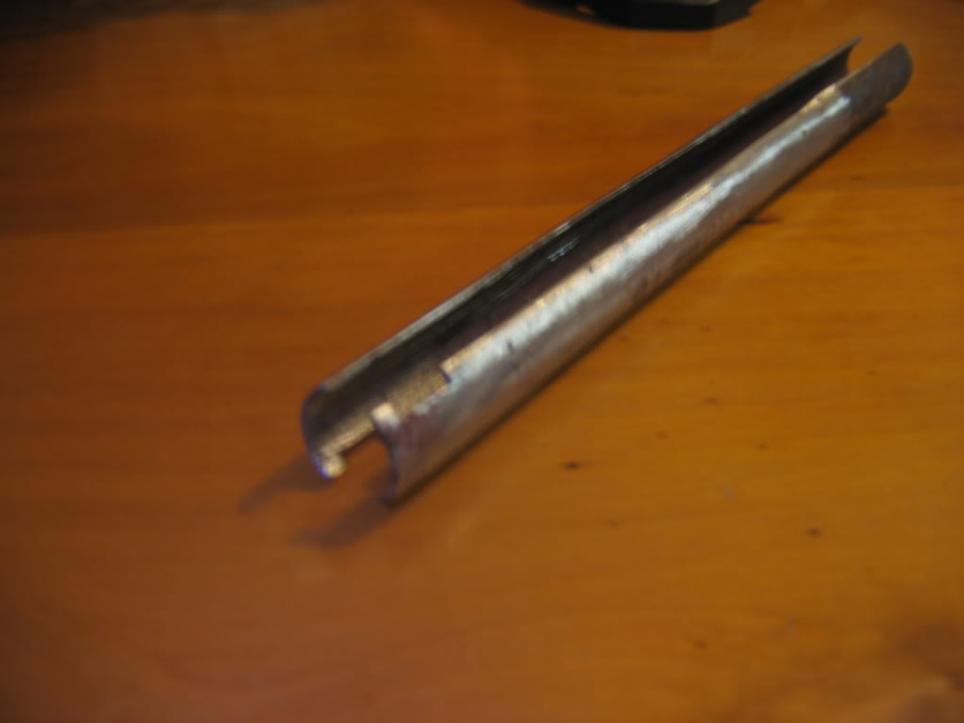

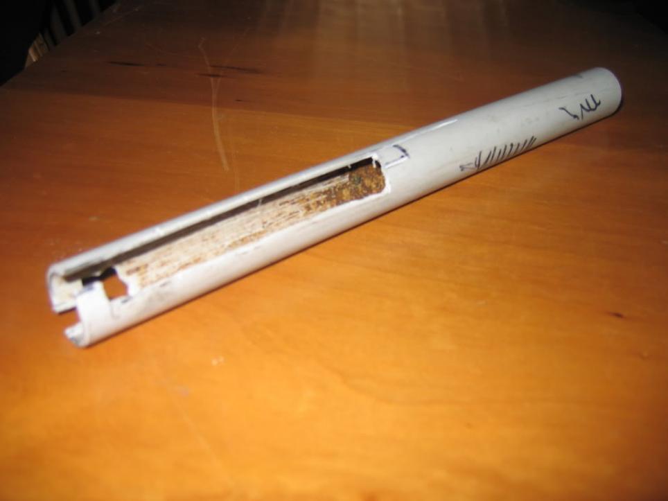

            Here is the DIY spark plug puller.
            First we made a concept out of plastic to get the general shape.
            Then we moved onto steel to get the final measurments.
            And the final product is made of 18mm ID alloy. Use either alloy or copper. To cut the slot you need an endmill or digrinder or dremel or a rotory burr.

                hey tazzie,
                I need a demonstration on how to use the spark plug remover tool lol
                It wouldnt even go over the lead ends (black rubber end) lol.
                I think I must have aftermarket leads
                So i kinda had to widen it up a bit for it to work. sorry.
                But even then i couldnt figure out how to use the cut out grooves to my advantage. I got the plugs off by pushing the tool over the plug until tight and then just pulling em off.
                So yea thats my experience with damn vr6 spark plug leads.
                Sorry i had to damaged your beautifully made tool tazzy

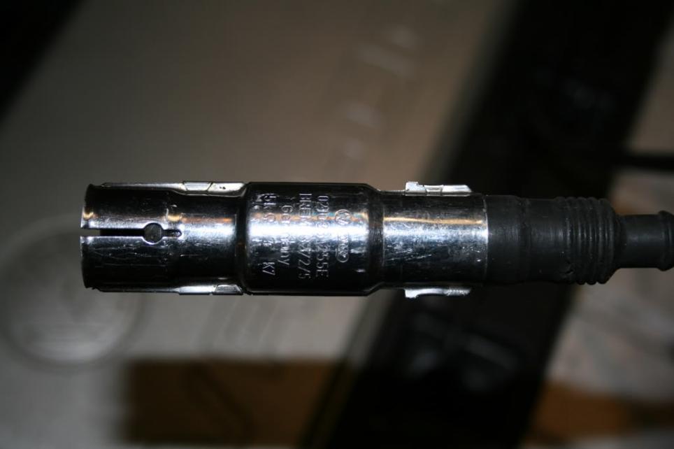

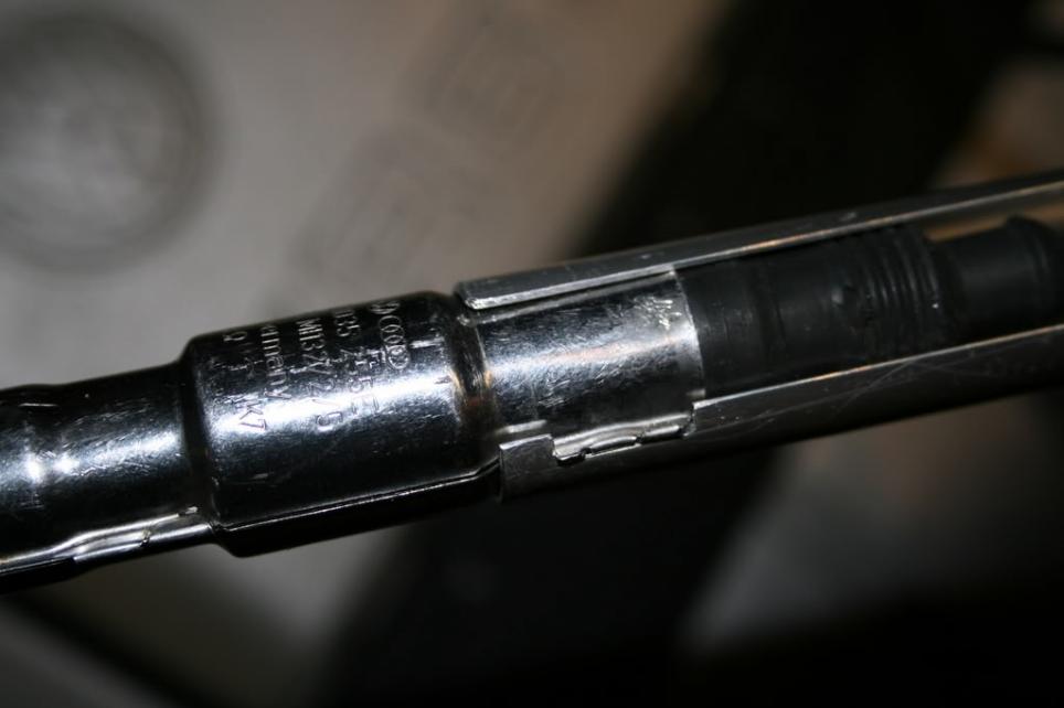

                        this is what my spark plug leads look like...

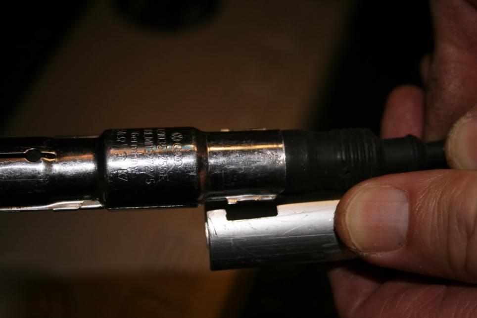

                        You can see here the slot in the tool is made to fit the little flanges on the leads

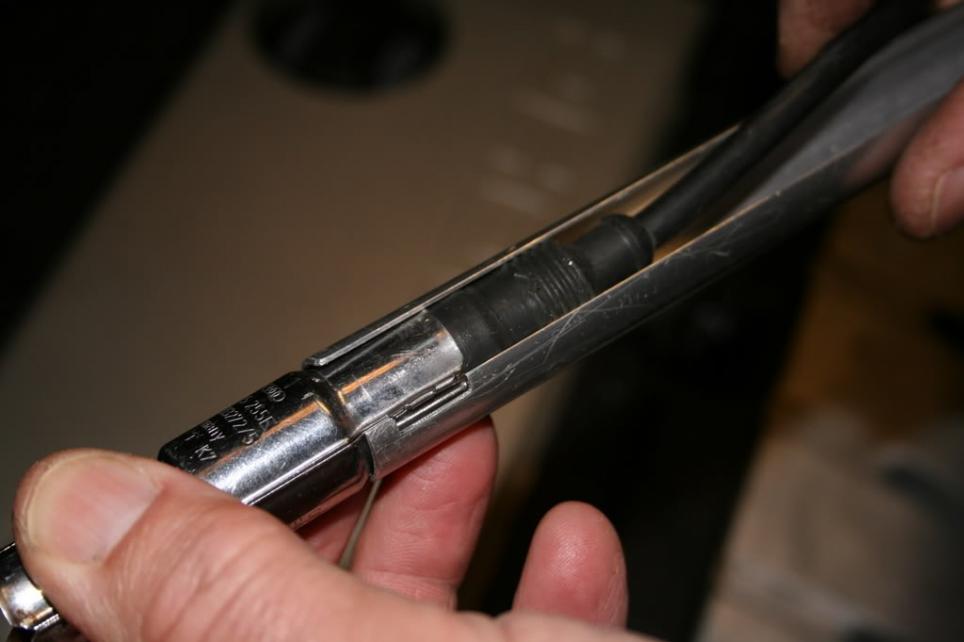

                        So you slide the tool onto the lead and over the flange as per these images
                        Also helps to spray some CRC inside the lead, makes them go on easier
                        Hope this helps
