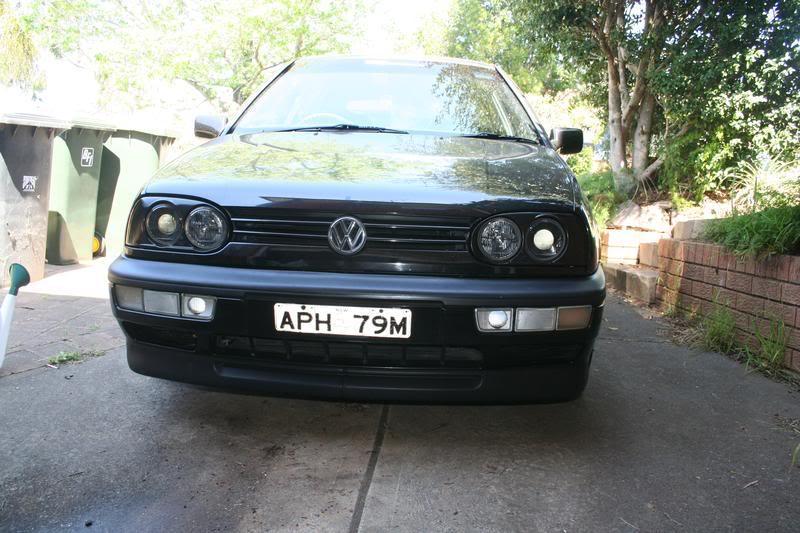

    Hi all.
    I'm pretty disppointed with the headlights in my mk 3. party cause they arn't aligned, but mostly cause the headlight output is just dismal!
    I've currently got some mk 4 lookalike head lights in (which I'm desperate to get rid of!)
    I'd like to move back to a standard dual chamber but also get some really good light out put.
    Is single or dual chamber better? What's the go with HID's? Some bulbs better than others? Relay/wiring upgrades?
    Any advice, tips, tricks etc is all aprreciated, fire away mk 3'ers!
