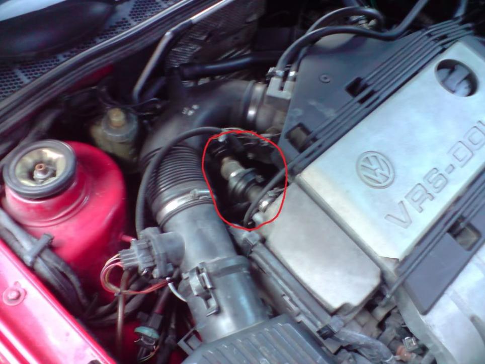

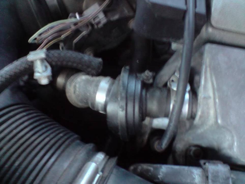

    Hey Everyone, just got my VR6 yesterday, quite happy with it Just wondering what this little unit showed in the picutres is? It had a little tube attached which has broken off, and i will need to replace/fix ASAP, but just need to know wat it is first? Thanks (Sure its quite a noob question)
    thats the pcv valve, pretty common to break on the vr6. Quite expensive to replace as you cant just get that piece but have to get the entire plastic intake thing.
    A cheap fix would be to put a breather on the crankcase like I did (ill find a pic in a sec) and block the whole in the intake. Or you could just replace the whole thing with a bit of hose, which is probably more legal (have a feeling the other way isnt) but you may have to clean out the throttle body every now and then.
    Theres also a "PCV fix" and other things like that availiable from 42DD

      Mine died about six months ago and was replaced with a hose and the hole in the intake was blocked off... done about 10,000 kms since, i pulled the intake off and cleaned the throttle body up the other week and was very suprised at how clean it was in there.... so you should be fine if you decide to replace it with a hose

        Either buying the whole new intake boot or doing a ghetto fix both work.
        Mine was broken for pretty much years, and I eventually ripped it off and put a breather thing on the end as in the pic above.
        Eventually decided that was too pov and bought a whole new intake boot for 200 bucks.
        Alternatively, there is at least one 'PCV fix' on the market which replaces the whole thing with a different set up.
          Yeah, mine was originally replaced with a straight pipe which became brittle and cracked (although to be fair it was just a spare offcut lying around) but then I went the NA route too:
            Thanks for that guys, it isnt the actual unit that broke, just the little pipe on top, which part of the stem on which it was sitting on broke, but its back on now, will see how it holds. Would a drop of super glue be ok just to join the two plastic components?
              might actually rip mine off and do the block off trick, its currently smothered in some sort of glue/sealant from the previous owner..
                mines busted too and yep replacement is 200! I will look into options

                  when it comes time to fix mine properly I'm thinking I'll go with this: 42DD Vr6 Upper intake tube
                  they also have this which would also be very nice 42DD PCV FIX
