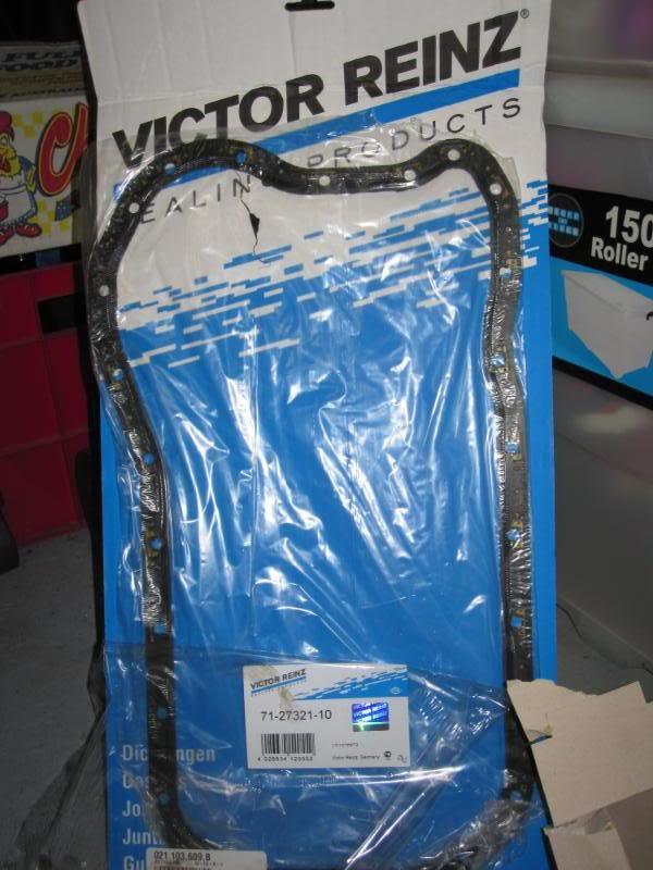

Armed with a new gasket, oil filter, filter seal and crush washer it was time to crawl under the car.

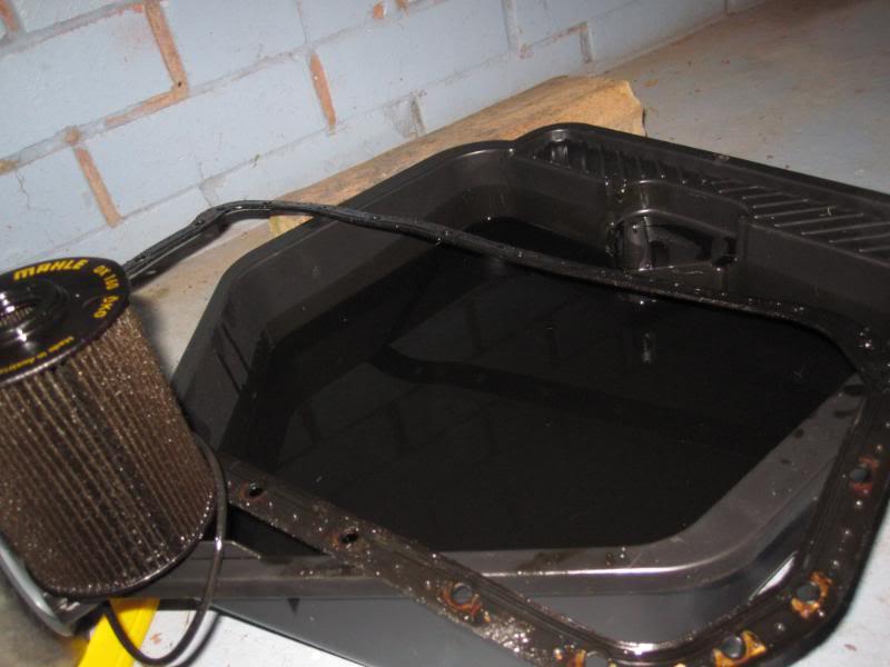

29 bolts later and the oil was drained and the pan was off, I had read through a couple of walk throughs but there seems to be a few minor differences, but luckily nothing of consequence.

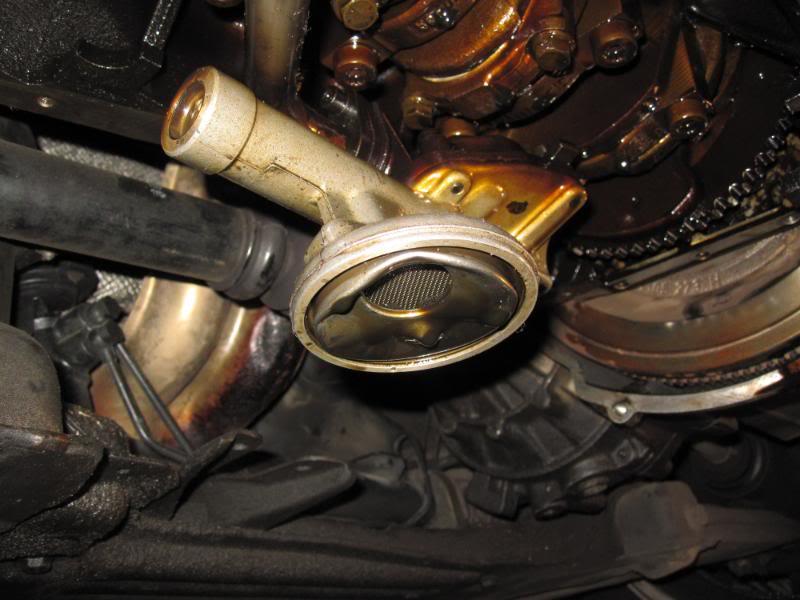

Seems my pickup has been a little hammered:

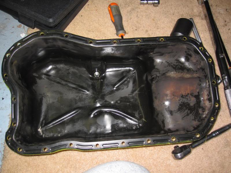

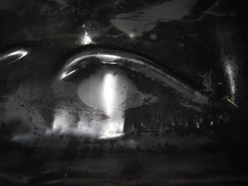

You can see the inside of the pan has a few dents:

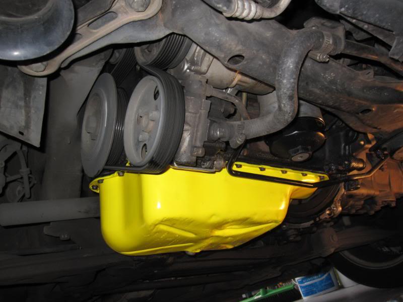

And while I had it all out and cleaned up I thought to myself... why not add a splash of colour with the left over calliper paint I had
The old gasket actually looked to be in pretty good shape so I'm not sure where it was leaking but it's all back together and taken for a 10 minute drive and I can't see anything leaking.
