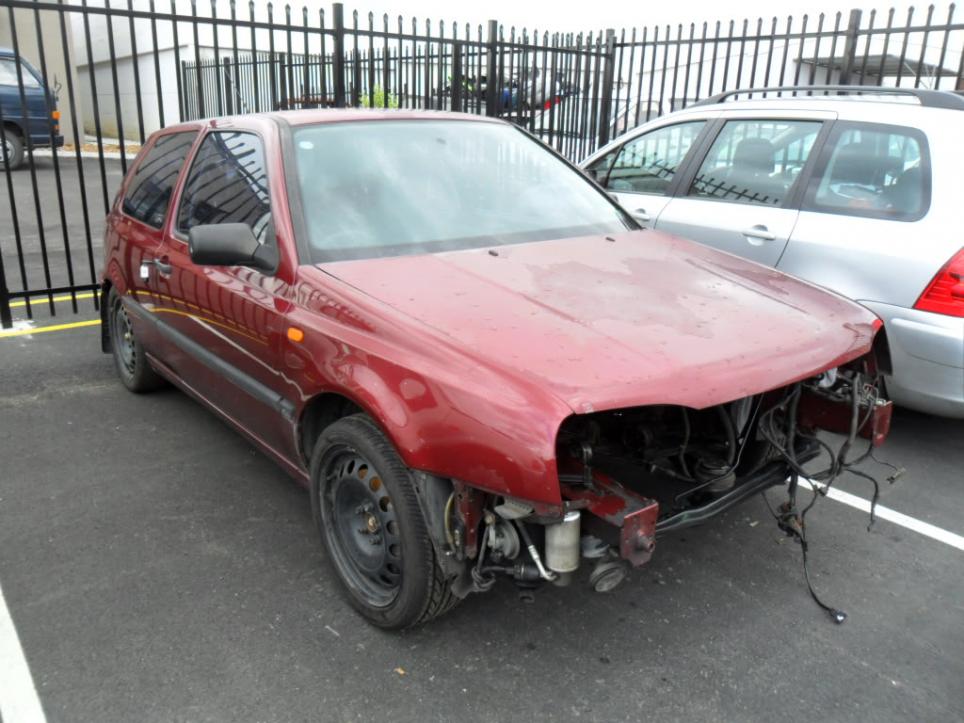

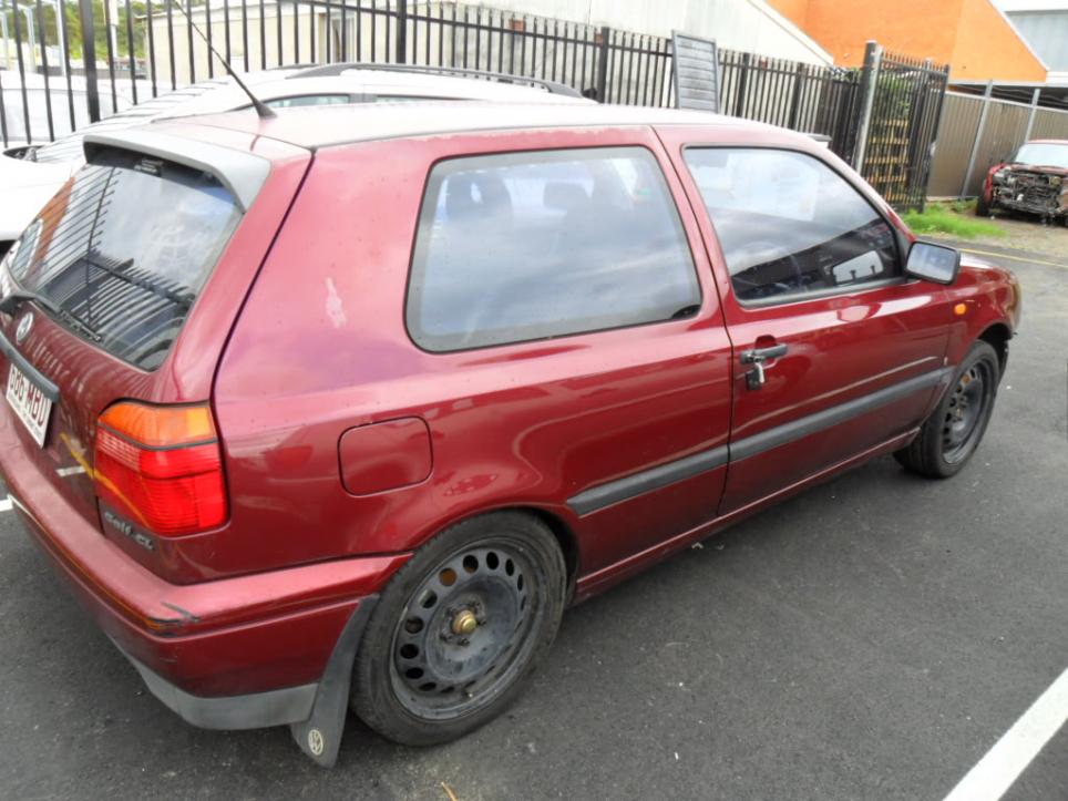

    Finally managed to get on with this project this week to replace Daves Cupra which was tragically T Boned by a Golf 6!!
    Ripped the weasly 1.8 heart out of the CL.
    Slotted in Mk3 VR6 front subframe, wishbones and 288mm brakes, straight bolt in.
    Also fitted the VR6 rear beam with integral swaybar and rear disc setup.
    As it sits now

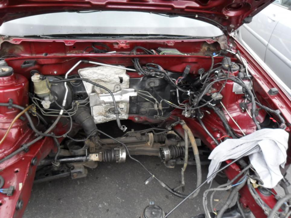

    Dash is out, new wiring loom is in and parts are at the ready. More soon.

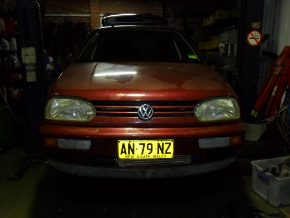

                        Cupra seats all fitted up now, needs dash and engine.
                        Challenge is gonna be fiting ac, intercooler and radiator in the front and keeping the stock look.

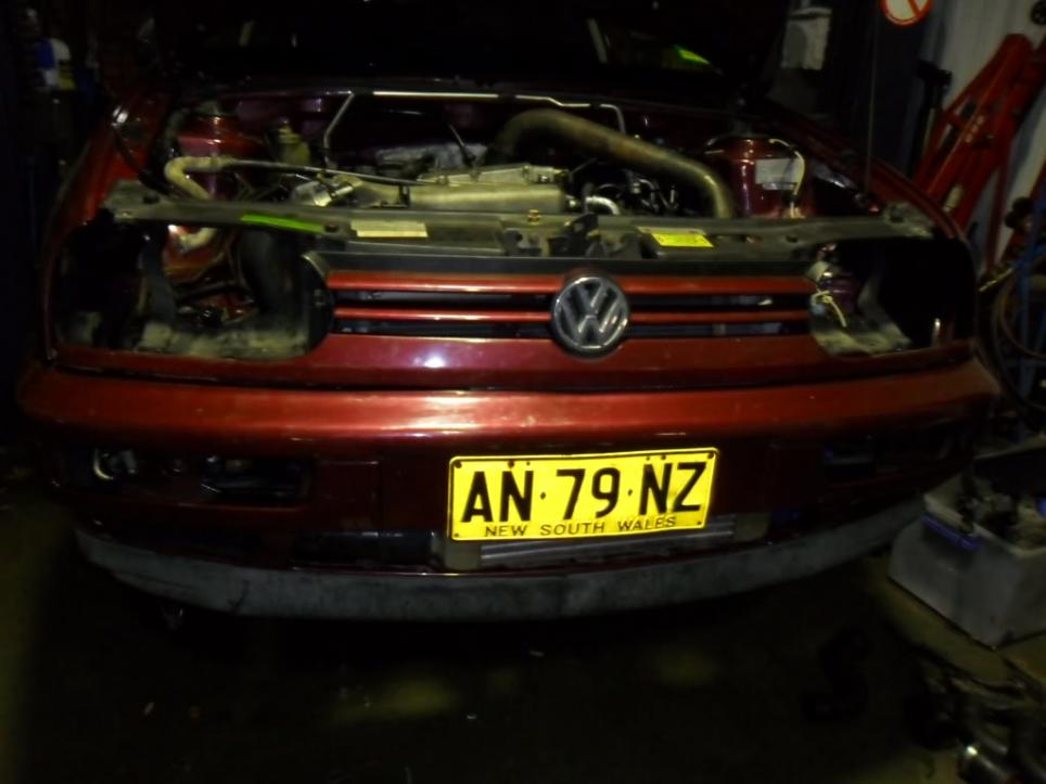

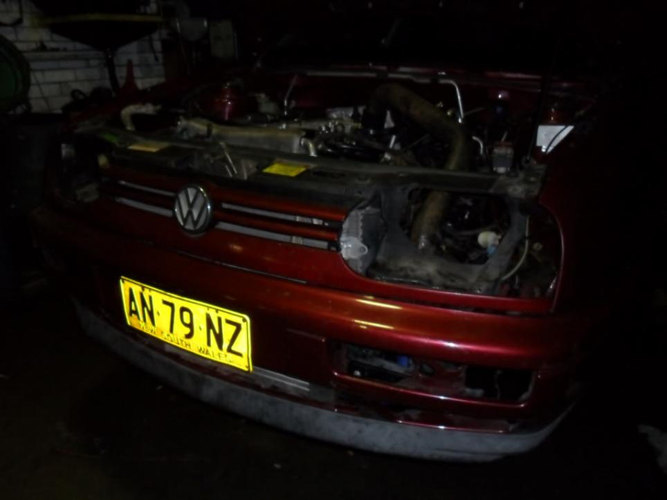

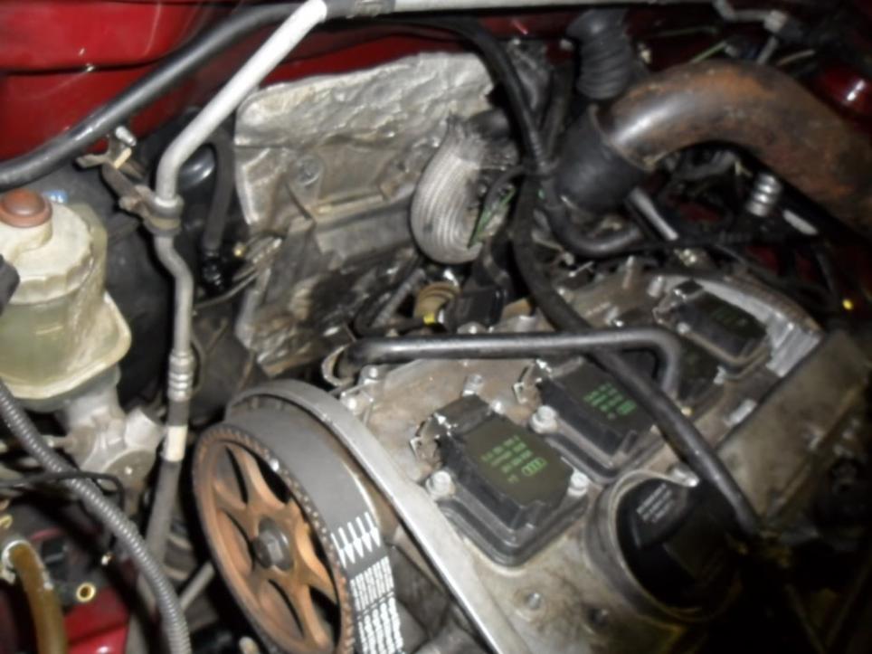

                            OK, so tried the gentle persuasion approach with fitting a massive intercooler into a Mk3.
                            Didn`t really work out, so got the grinder and air saw and got into it
                            This is what I came up with

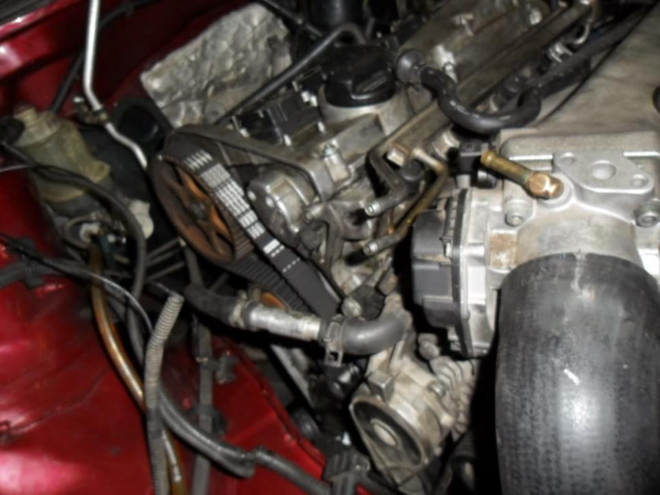

                            Motor is in, more booster / master clearance than on a Cupra, thats for sure
                            Started fitting up the front, this is how she looks now. (The plates have been changed to protect the guilty)
                            Lots of plumbing to do in the engine bay. More soon.
