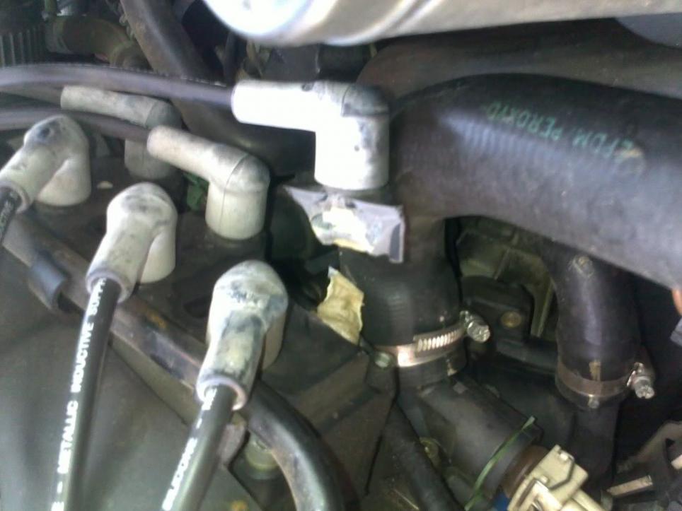

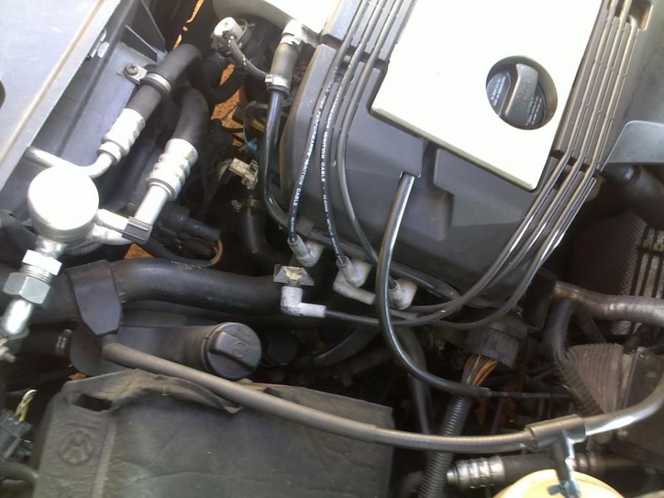

              so i think ive found the problem:
              i was looking at the engine the this morning and brushed the plugs and the 6th one and plastic around it just fell off.
              95' golf VR6
                LOL yep you got it!
                  Hahah yeh Ithink I've been looking at the mad to much...
                  Looks the previous owners done a dodgey job with some epoxy cement.

                      You can drive it gently, but its only working on 5 cylinders remember.
