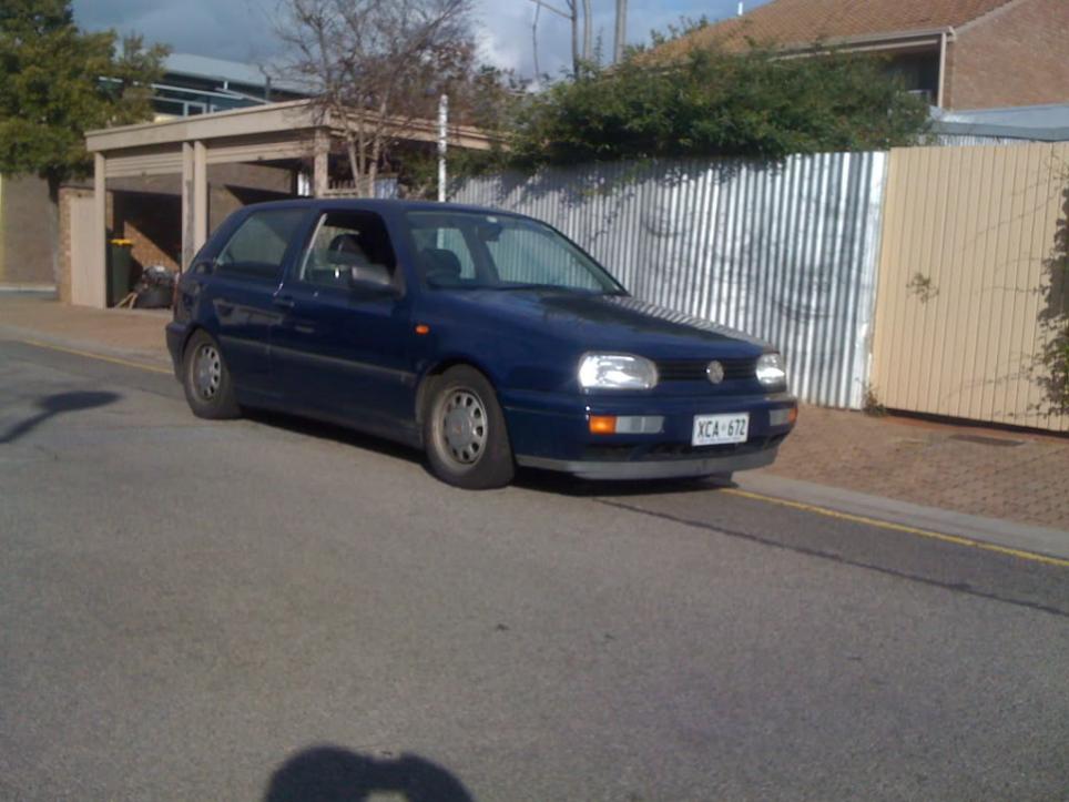

    I gave Lorenz a lift a few years ago to pick up his Mk3, and it appears to have rubbed off on me. I noticed a couple of months ago that a kid at work's mother had a clean looking 3 door Mk3 so I asked him to tell her that if she ever wanted to sell it I'd be interested... Turns out she was looking at getting a new car so I ended up buying it last weekend.
    Probably shouldn't have looked at it in the rain, its not quite as clean as I thought it was but it has lowish km's and the interior is spotless and other things can be fixed over time.

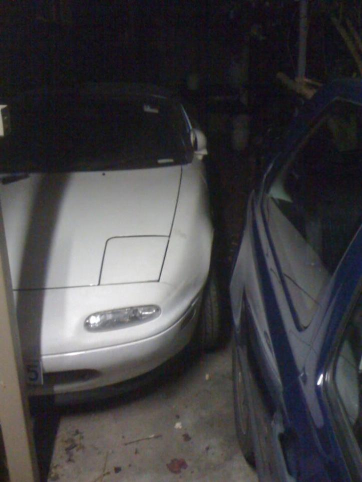

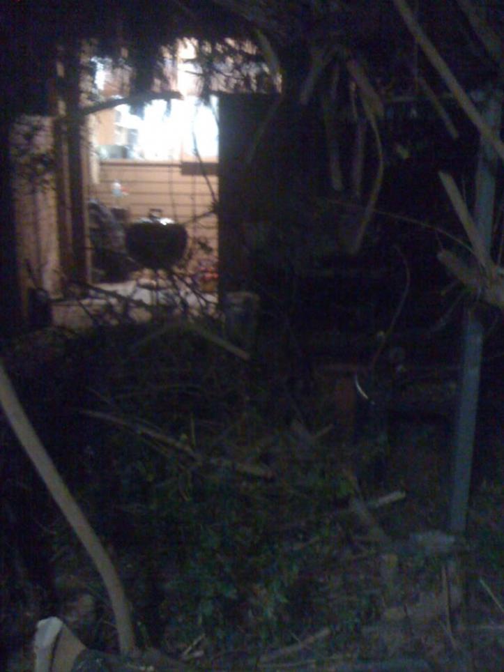

    I had to cut down a couple of trees on the weekend that divided my carport from my courtyard so I could fit the MX5 in there and the Golf in the carport
    Mission accomplished. Kind of got the MX5 stuck though, the battery is flat so I had to push it back and forth trying to manouver it around that pole and one tree stump that I ran out of time to get out of the ground, with my 13yo half-brother steering, ended up parallel to the brick fence with about 1cm clearance... whoops. Had to get the scissor jack out so I could get the trolley jack under the diff and roll it across a few inches, then when Tom got back in so I could push it back out of the way he twisted the key when it was only halfway in the ignition and snapped my only key. I was not overly happy... All good now though

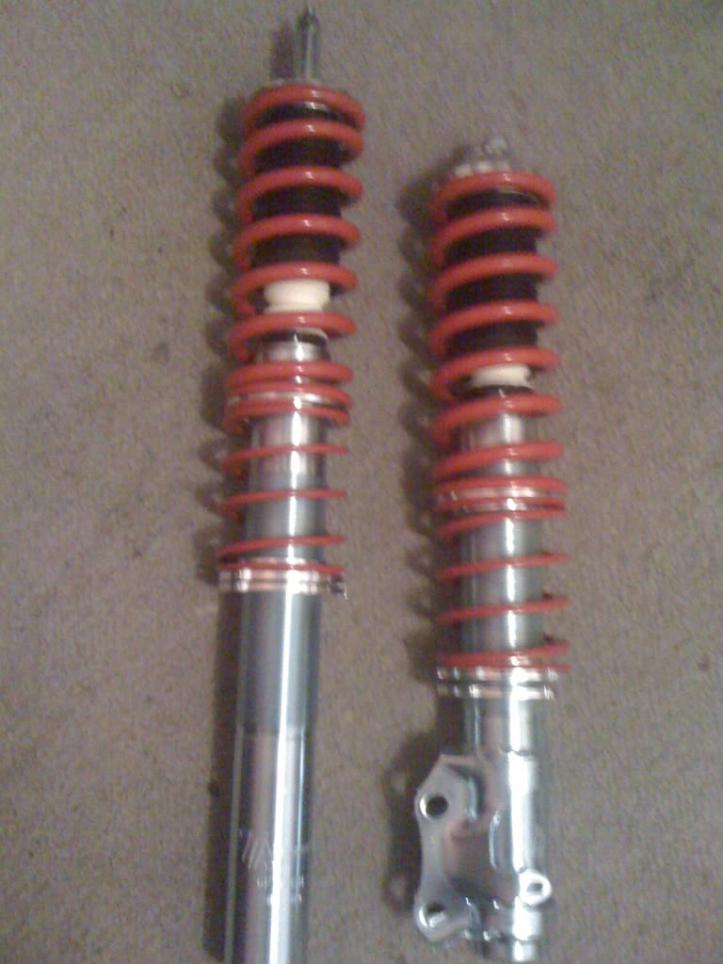

    Bought a set of Hottuning coilovers from Lorenz and Robin, they'll go in soon

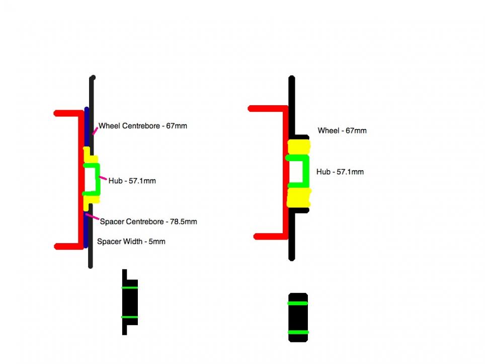

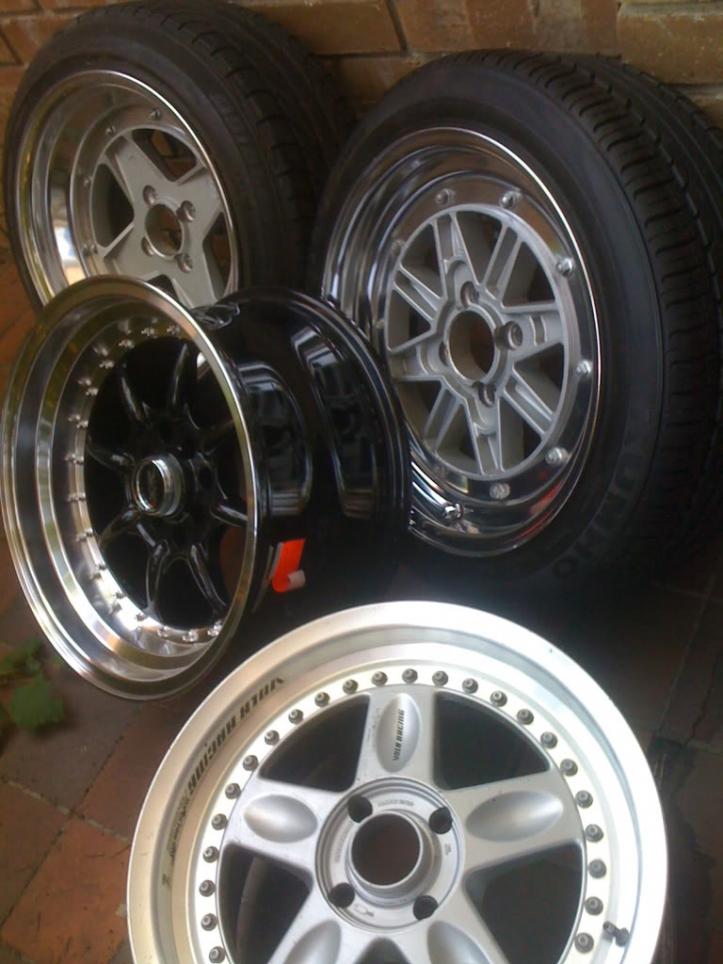

    Planning on putting my SSR Mk3's on it (mainly because I like the ideas of Mk3's on a Mk3) 15x7 +26/13, but I need to get some hubcentric rings to suit them, plus some 5mm slip-ons to clear the front brakes

      Put the coilovers in over the last couple of days (had a couple of bolts that didn't want to budge, coupled with working 7 days and no shed, had to do it one corner at a time.
      Still need to set the heights but I think I should let the springs settle first. As I plan on driving it as a daily I can't go too low (don't want the hassle of defects) so the rear will have to come up a bit, not sure on the front yet
      I'm getting some hubcentric rings made up by a mate so I can run my SSR's, just a normal ring for the rear but a stepped one for the front because I need a 5mm spacer to clear the brakes

        nice man the coils should drop about 5 to 10 mm after a few months, mine did

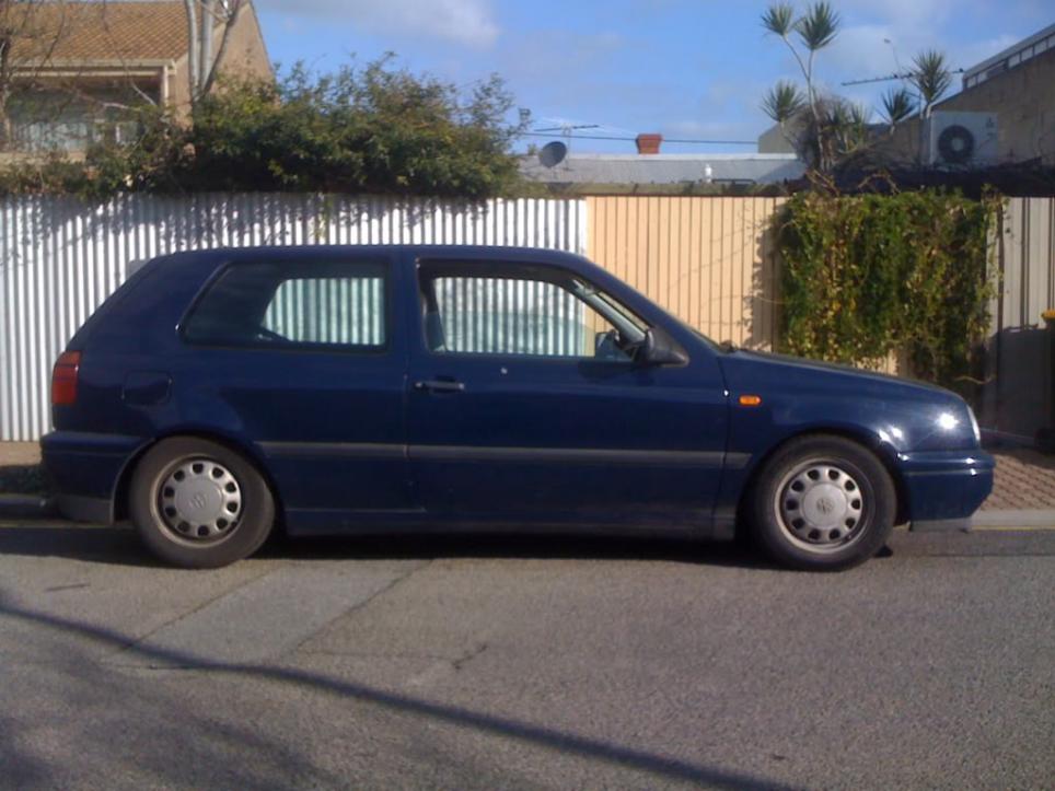

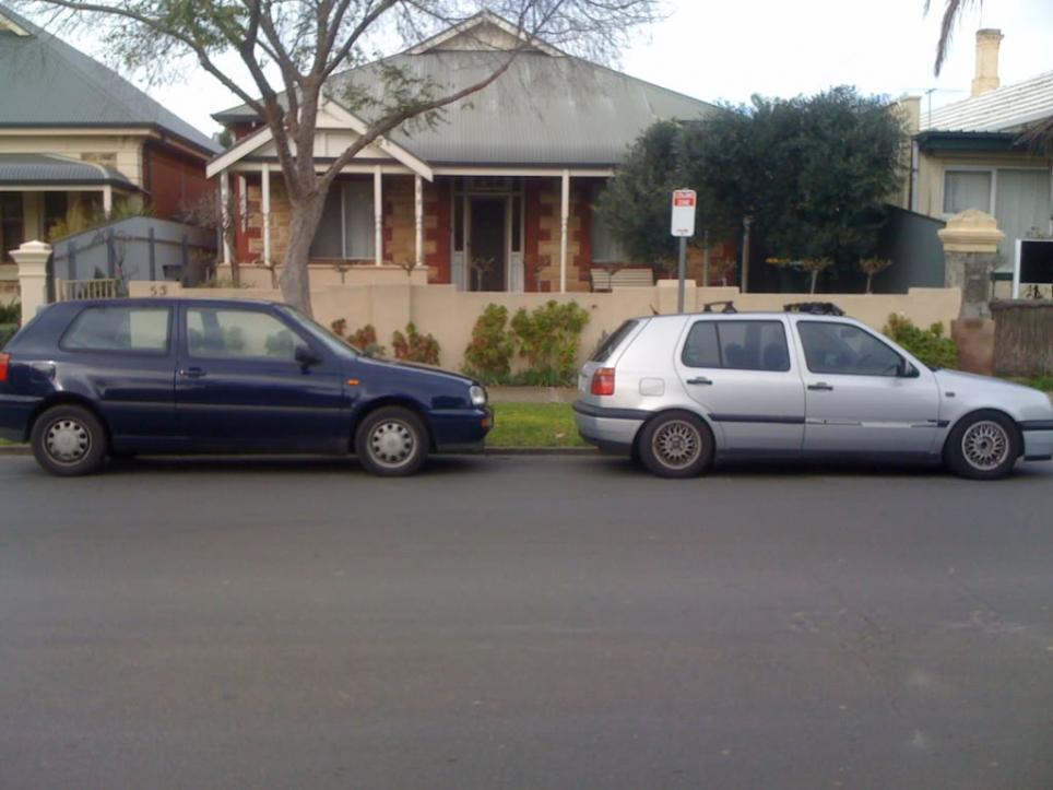

                            Excuse the phone camera pics, just wanted to see how it was sitting when I was at work tonight. First time its been out of the driveway since I put the coilovers in other than going around the block and straight back in to get it settled and turned around to do the other side. EDIT - replaced photos with better ones from today
                            I'm used to a bumpy ride (8/6 springs in my Stance GR+ in the MX5) but jesus this thing rides rough now, you can feel the back bumping around heaps, it was a nice little car before I did this...
                            I wound the right rear up a bit the other night (set the left rear higher when I put it in because I thought the RR was a bit low) not sure if its still a touch too low or not

                              i think the height looks pretty good, if anything id go lower, but thats me I also found with my hottunings that after a few days/drives they became a bit less bouncy and ride pretty good now, so as they settled they may have become a little less stiff or something, or i got use to it pretty quickly.
                              being able to go through roundabouts at like 60 makes it worth it though
