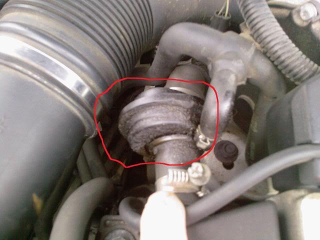

    This part of the intake boot on my vr6 is split and doesn't connect up anymore. How bad is this? When I started my car today it blew out a small cloud of blue smoke. Just wondering if it is somehow related to the pcv valve not being connected up right? Although then again, I hadn't driven my car for a week...
    I also noticed that you can't buy this small section as a seperate part and you have to buy the whole intake boot if you need to replace it

      Yeah I found it on gap for roughly $200 so I am just gonna bite the bullet and get it.
      What I was more concerned about was the blue smoke that came out the exhaust, and whether it was related to the pcv or if it is something more serious like valves or piston rings. It was just one cloud on startup, once car warmed up there was no smoke, even when I revved it, and it's a cold day here in Melbourne.

                What I still wanna know is, is it bad to run the car like that with that hose broken and disconnected?
                  Yes, that pipe is after the MAF so it’s cracked or broken it’s letting in un metered air. As was said you can simply put a breather in it’s place and block up the inlets on the intake.

                      You can get the PCV valve separately from the the dealer if you use the one for the Sharan. Only thing is I'm not 100% sure if the PCV valve is exactly same as the mk3 golf VR6. It's still expensive, $137 NZD, but better than $300+ for the PCV and intake.

                              So I'm in the same situation now. Quite frustrating re having to buy the whole intake section. Barloworld said they'd do it for $260 but that's still a lot for parts I don't need. (See pic below). Has anyone done a DIY oil catch can? Is that a logical solution to the problem or just as expensive?
