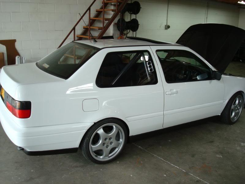

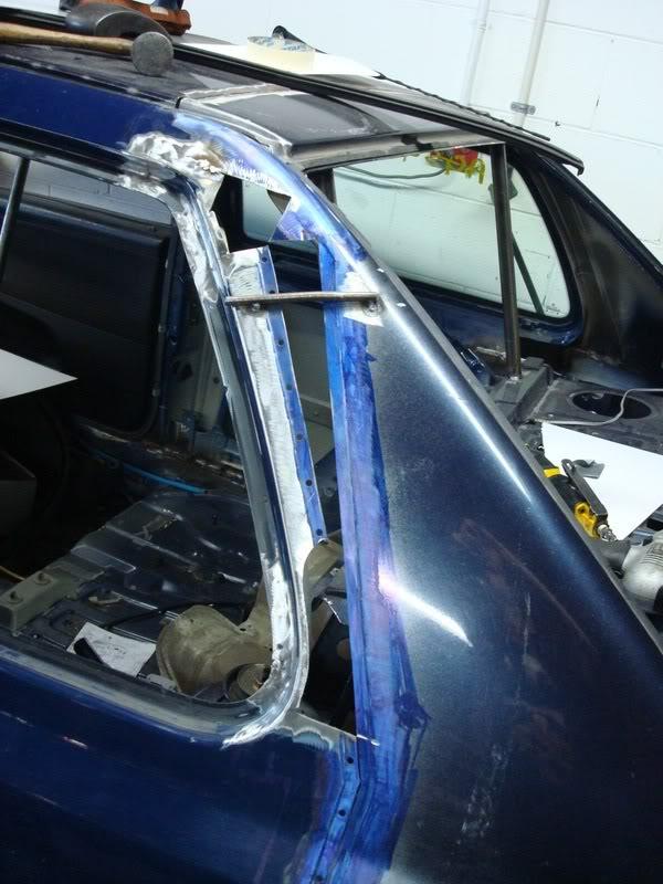

    Hey guys, just joined and thought I'd share this Vento coupe we built over the last year and a half.
    Running MK4 1.8T with Garret GT3071R turbo, Eurodyne 630cc file, LSD 02J box, 6 point roll cage, MK4 dash and the list goes on.

      Here's the link to the full build
      Its a bit of a trawl through 60 odd pages but there's loads more detailed pics there and worth the read.

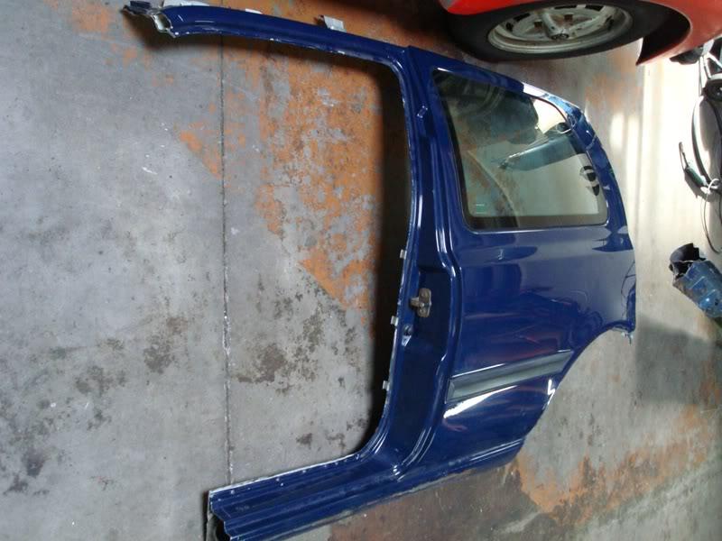

      I have a pair of 2 door MK2 rear quarter panels already drilled apart for a 2 door Jetta I was going to do, won't be using them now as I'm doing a MK4 Bora 4 motion 2 door instead
      You want the panels as they won't be used now........?

          LOL, forgot about that. Limited to 15psi so far and lots of wheelspin already even with an lsd.

                  Going to the dyno tomorow, will be interesting what she pushes at 15psi.
                    Dyno run today, 214.9kw @ wheels running 15psi boost.
                    A little lean at the top end but a play with the Maestro software should sort that, keen to push a bit harder now..............

                          Yup, DBW and wideband so that we could run late ME7 ECU for more tuning options.

                              Here's the dyno day video link, 15psi run:
                              YouTube - 1993 VW VENTO COUPE @ Torque Performance 20.3.2010
                              We'll be going back on the dyno in the coming weeks, first will be 20psi then 25psi -can't wait
