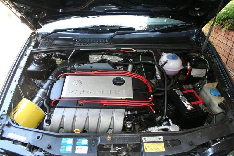

    ...and what about the leads on a VR6?
      On a 4 cylinder they go 1. 3. 4. 2.
      Clockwise from the lead nearest to the corner of the block if your dissy is in correctly.
      VR6 coilpack has numbers next to each socket if you look properly
        Off the top of my head, If you face the engine and number the plugs from left to right, top to bottom you get:
        1 2 3
        4 5 6
        Then on the coil pack you have:
        4 3
        5 2
        6 1
        Does that sound about right?
        edit: Looks about right from what I can see in this photo too:
          Not quite mate, looking at it the cylinders go left to right crank pulley to fly, so it would be start 1 top, 2 bottom, 3 top, 4 bottom, 5 top and 6 bottom can only naturally be this way
          So like this 1 3 5
          2 4 6 this is how it is on the engine in this arrangement
