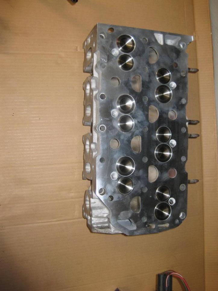

                        This thread has so little useful information . Take the head here or take it there . Very few people have any real experience with these engines in this country . Porting the head and getting the right flow figures is crucial with the different runner lengths . Porting is useless without a decent cam (268 or larger) . You also cant just machine the head , there is no combustion chamber in the head on a 12V :
                        if you want to machine the head you'll need to pull the valves out and probably redo the inserts . To raise compression ratio you can either run a mk4 headgasket or change the pistons .
                        The only advice I can give you is take it to someone thats done one with proven gains . You'll need a chip as well as sorting out your fueling issues .

                              Thanks for the info Seb. I didn't want to machine the head to gain compression. just simply to clean it up if need be. Also i will be sourcing a mk4 gasket from the states. As for George, I've been a mechanic for audi for 7 years now so i guess i have a little experience in he field. I wasn't having a stab at golf loon, simply asking the question because as a mechanic it sounds insane to me to pull the gearbox out unless you need to replace the chains and guides. Should he have stated that the chains should be replaced due to the extra valve train stress than i would understand but as far as pulling the gearbox out just for fun it doesn't particuarly make sense. I'll try contact goodman race engines tomorrow. As Seb stated it would be best to find someone with experience and proof of gains which i was hoping to find not an argument about how to pull the head off.
