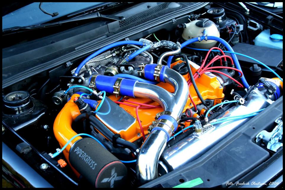

        Here are some fave pics

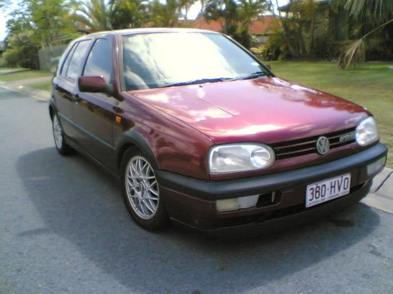

                what its going into -
                who likes my shroud for cold air? rofl
                EDIT: Oh and does anyone know what colour code my car is? I know all the American colours but not Australian issued ones. Its burgundy metallic looking.

                    Hot chilli red pearl.

                        Thanks dude do you know the code at all?
