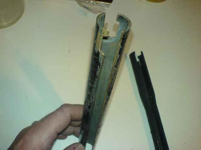

            I do need to change the plugs actually, i am having trouble finding a tool that can get the plug boot off, my plastic one is rooted.

              Long nosed pliers $9 at Supercheep
              • #22
                if u need a hand with it i have a bicycle handle bar that i attacked with an angle grinder and a dremel to mimic the shape of the factory puller.
                If u pop over i can either lend it to you or we can change ya plugs here if ya want. its only a quick job
                errr if i can find it!
                    Show us a pic of this custom tool Tim.
                    • #25
                      well its pretty crude but at least its not made of plastic! took me about an hour to dodgy up.
                      In the background u can see the original plastic one which has broken tabs. which was i made this one to start with!

                        Hazet sell a tool for it if you have alot of $$$

                          Go the ghetto stylin Nice One Tim
                          • #28
                            with a dremel and a can of WD40 the sky is the limit!
