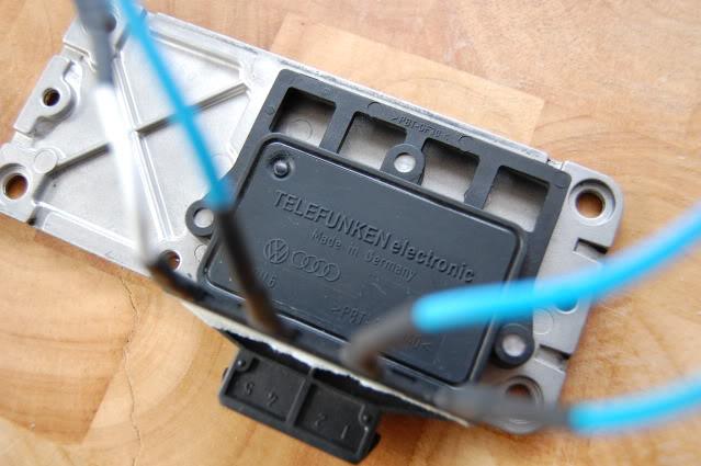

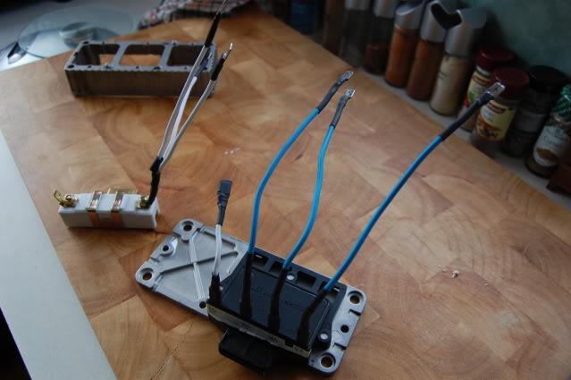

                    not long till the parts are here so I started the wiring.
                    seems like alot of guys on vortex had a problems with this setup, destroying their ignition control module and frying their new MSD coils.
                    could be caused buy bad wiring...
                    so after soldering, shrink wrap etc, i got it done.
                    pics so far. doesnt look like much but when the other parts come in it will make more sense.
