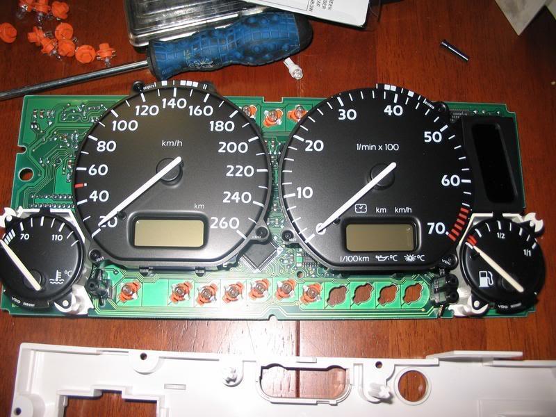

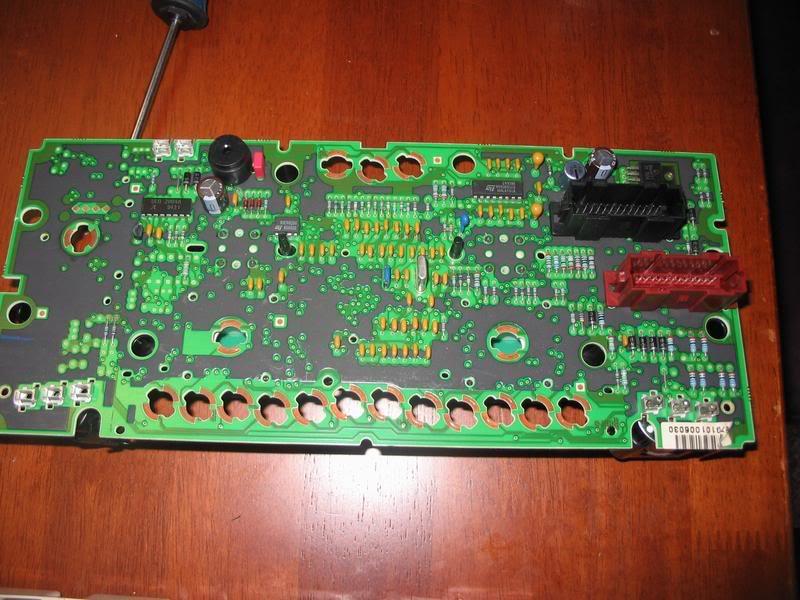

        For reference, this is the older cluster:
        This is the newer more high tech chip driven cluster:
        Notice the front of the older cluster, it's all one piece:
        The newer ones can pull of and switch around the components if one dies:
        As far as I know, once it's dead, it's dead and your up for a second hand one with whatever km's on it, or you can get a new one from VW for an extortionate amount.
        PS mine did the same thing, new one fixed it right up
          Its a known fault. VW techs call it the dance of death!
          Its a problem with the CPU. A new cluster is the only answer.
          $550 brand new from VW, with 0 ks. $150+ used with whatever ks are stored on em.
          I have sent a few clusters to instrument repair guys who are always so confidant they can fix em. They never have....
