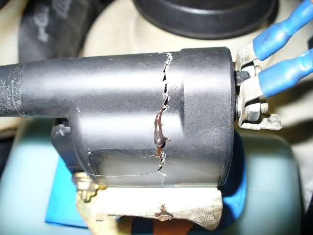

    Sorry about the sensational title but it's what happened.
    This is the second time in two weeks that a coil has "failed" on this car (95 Seat Cordoba).
    First time was an original vw coil/ign module - at least a couple of years old- second time was the pictured Bosch MEC717 controlled by the ign module off an original coil - I bought it second hand off an Ibiza (I think) as it was all I could get quickly. It ran fine for two weeks.
    First coil blew after I'd left the ignition "on" for a few minutes, second one the same (I was trying to get the VAG-COM software to recognise the cable I'd bought).
    The heatsink that the ign module was attached to was hot enough to burn (and blister) my finger.
    There is an ignition problem but before I start troubleshooting I need to know if it's the norm for the coils on this era vw's to cack it after a few minutes of ignition "on"?

      I`m not liking the crimped on connectors you have on that unit. I`d probably put it back to genuine.
      The other thing is make sure there is an earth from one of the bolts that hold the coil on, going to the engine block. I have seen this left off, resulting in massive amps at the dissy,which is also bad for your coil.

        OK so the coils don't explode as a matter of course, lol.
        Yeah the earth strap is/was connected.
        The car died on Fri and because there was power to the coil but no spark I assumed the coil had died.
        I got a Bosch replacement (another $60) from around the corner but still no go. I then persisted with the old coil for troubleshooting purposes.
        I tested the coil with test light and no blinking as motor was cranked so the no spark prob is before the coil.
        Installed VAG Com software and just before the car burst into flames (ok, ok... slight exaggeration) I managed to glimpse a Vag Com reference to a "Halls sender"... Hall's something, anyway.
