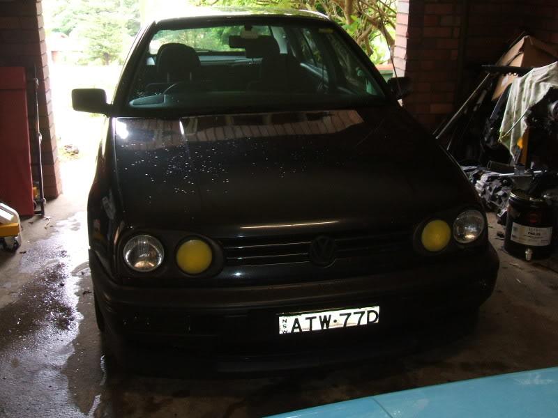

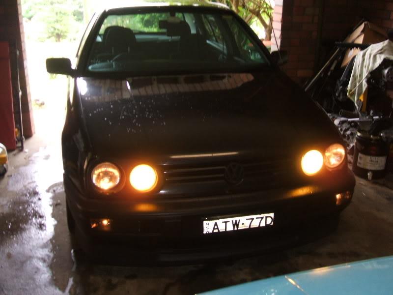

    thoughts???? sorry the first pic is so bad
    i've got lows and highs in the larger outside lights now, and wired the foglight switch up to the old highbeams (now yellow fogs) since i had to do away with my REAL fogs after the FMIC install (piping went through there...)

    They're um....very yellow dude! Hahah.
      mmm they do look very yellow... not as bad in real life - you can still easily see the reflectors....

        So you now have a dual bulb for high/low in one unit... interesting, very interesting. Not a fan of the yellow fog look, but I like the idea of the light setup.
          yeah, the dual bulb works great. i have installed a normally closed relay, to turn the low's off when the highbeams are turned on, so as not to overheat the bulb. when coming from the large light, the highbeam is nice and full, you dont even nitice that the low is gone.

            Great setup then Well if it's not as yellow in real life then I think it's cool....it's euro lol.
