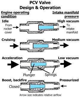

                          All car's (don't know the exact year when they were introduced for pollution requirements. think approx 74/75, as the HJ's didn't have any pollution gear in them) should have one of these fitted or a PVC valve equivelant system like the cyclone oil separator's as part of the pollution system.
                          That explain's how they work.

                            Yeah, don't think I have that valve anymore since it used to leak and was removed, but I assume the catch can/seperator take the place of that valve anyway, another reason to consider doing something
                              Some good info here, I finally understand how the PCV system works.
