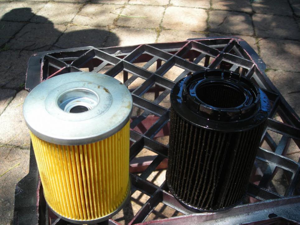

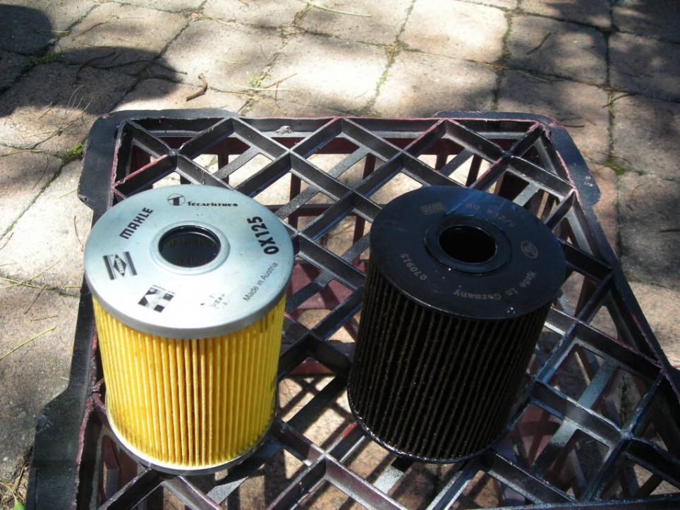

    Am I missing something or do I have the wrong filter for my VR6? ...
    yes you do.
    If you read on the Dub Addiction website the mahle filters we sell are for models up to a specific engine number.
    I believe its the final run of MK3s that share a similar filter to the mk4 12v engines as they had in the US. Most likely would be limited to MY07 cars which would be a very small amount in Australia.
    Feel free to send the filter back for a refund if you like. I need to do an oil change on my VR6 anyways
    FOLLOW US ON FACEBOOK
      Ah ok fair enough mate, I should have paid more attention to whats written on a site in the future. I'll pack them up and post then back to you on Monday.
        After "mid 96" (there is also an engine number range) they started using a different filter. If your stuck and need one today and can get out to Campbelltown I can lend you one
          Yeah i have the engine number listed on my website
          "Oil filter element to suit 12v VR6 AAA engine number up to 176899"
          Its basically MY07 cars. So anything built in the second half of 06 and onwards.
