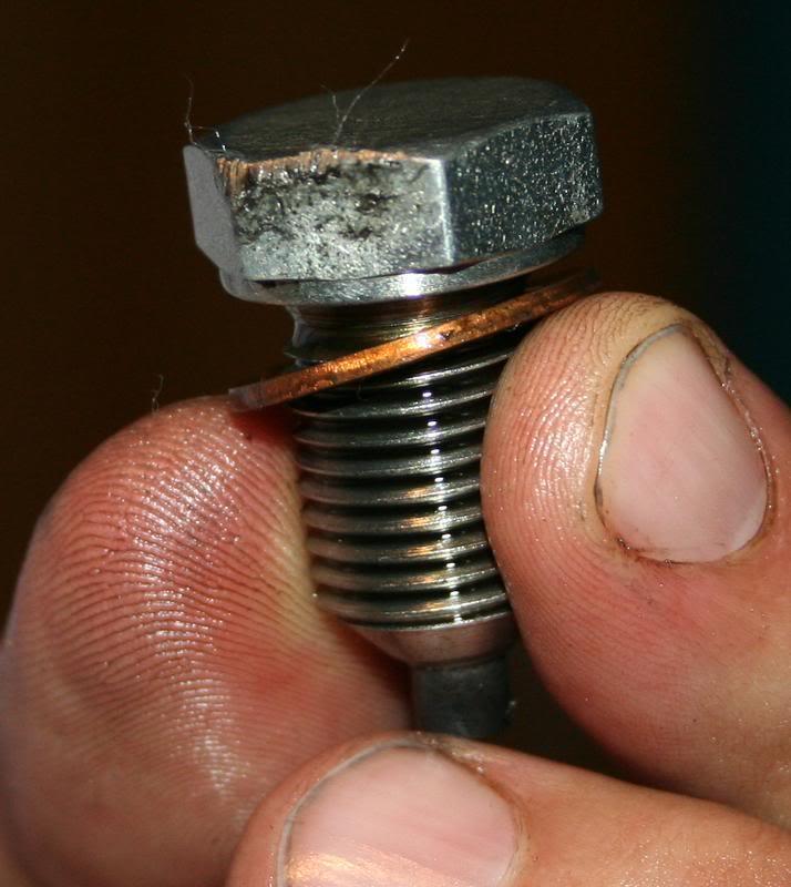

    Last oil change I replaced the old sump plug with one of the magnetic ones to see if there was much metal floating around (not that I thought there would be), also because the old one was starting to get ground away ... the new one is starting that too:

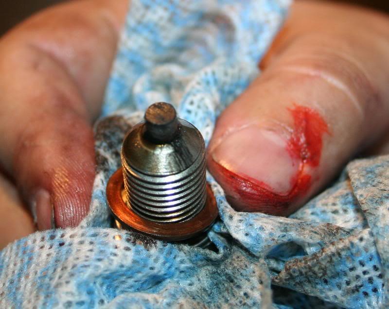

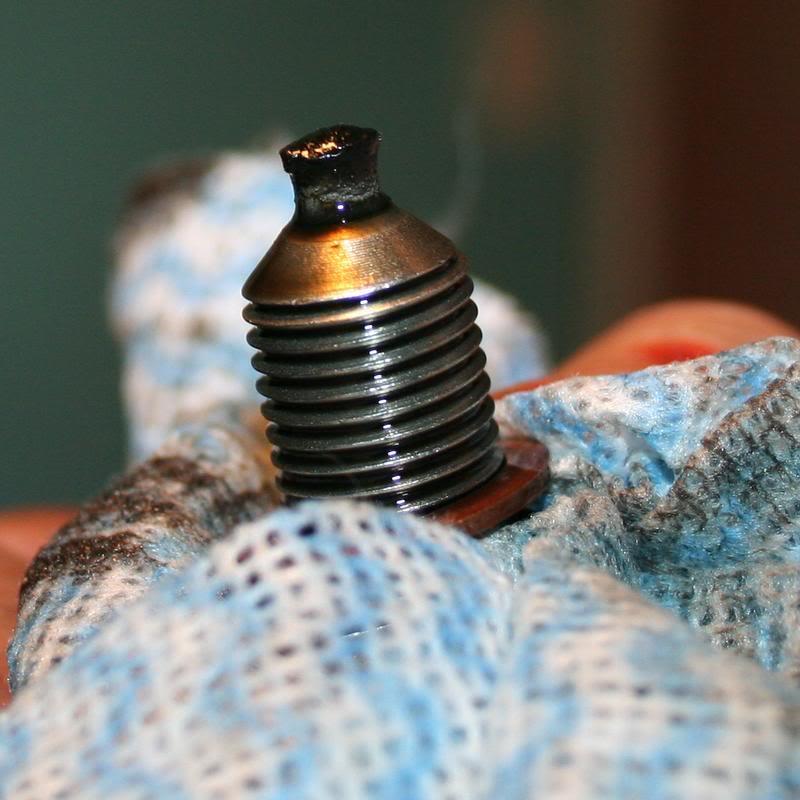

    The tip of the plug shows what it picked up:
    If it was metal and not just crud it was powder like, nothing that seemed metal when I rubbed it.

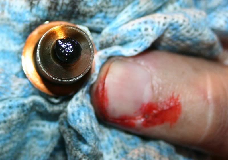

    And cleaned up for comparrison:

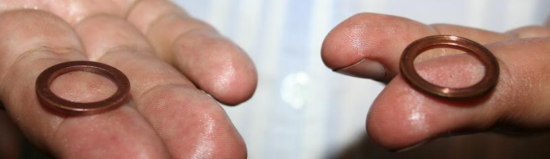

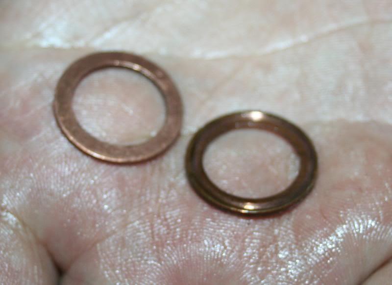

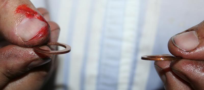

    And for those who don't bother to change the sump plug washer, here is a new next to the old one which has had a single use:
    They really do crush up a bit, well worth replacing every time.

      What happeend to your thumb, looks like a nasty cut.
        Originally posted by Soundofav6 View Post
        NOt all vr6s has cuise control right... I would love to have one.
        They came out with cruise standard in '94 i think.. Right?
        By the way, nice work on your thumb there aaron!
          Poor thumb

                The thumb, well yeah cruise pump plus tight places = sore finger
                  Bleeding to the car gods...Have to love it...You Should see my hands and arms after readjusting my TIP yesterday!!!
