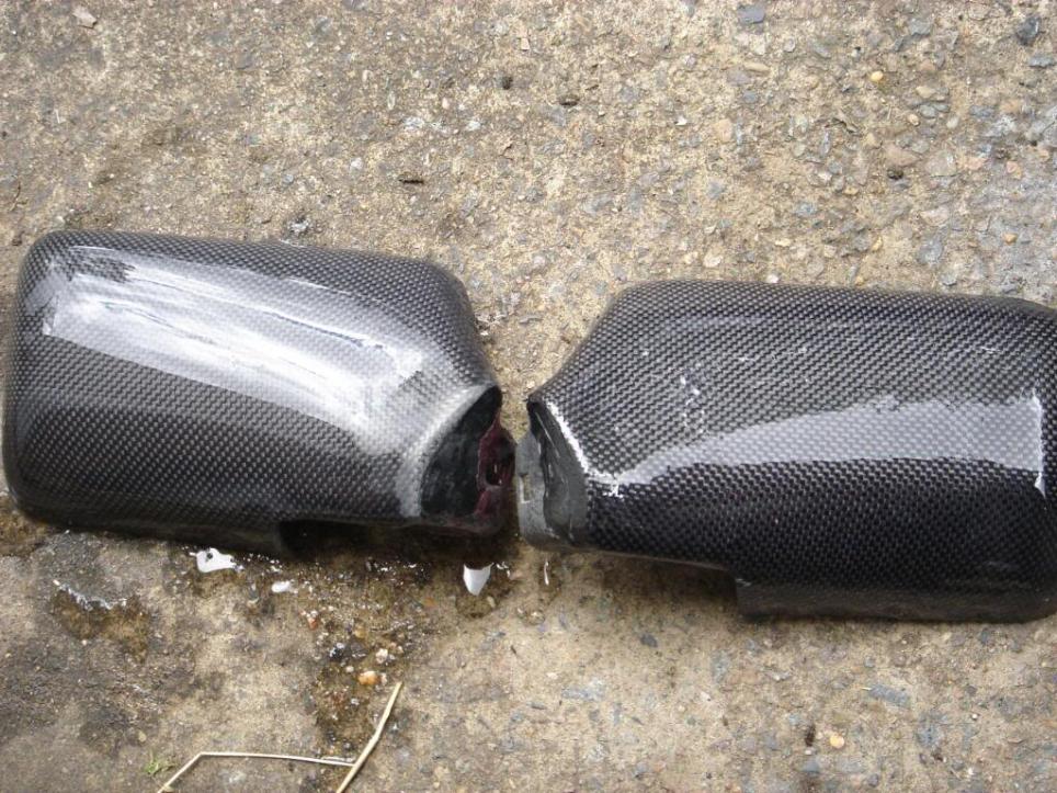

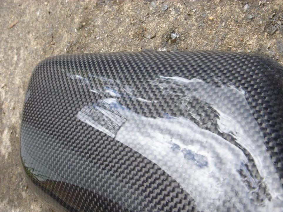

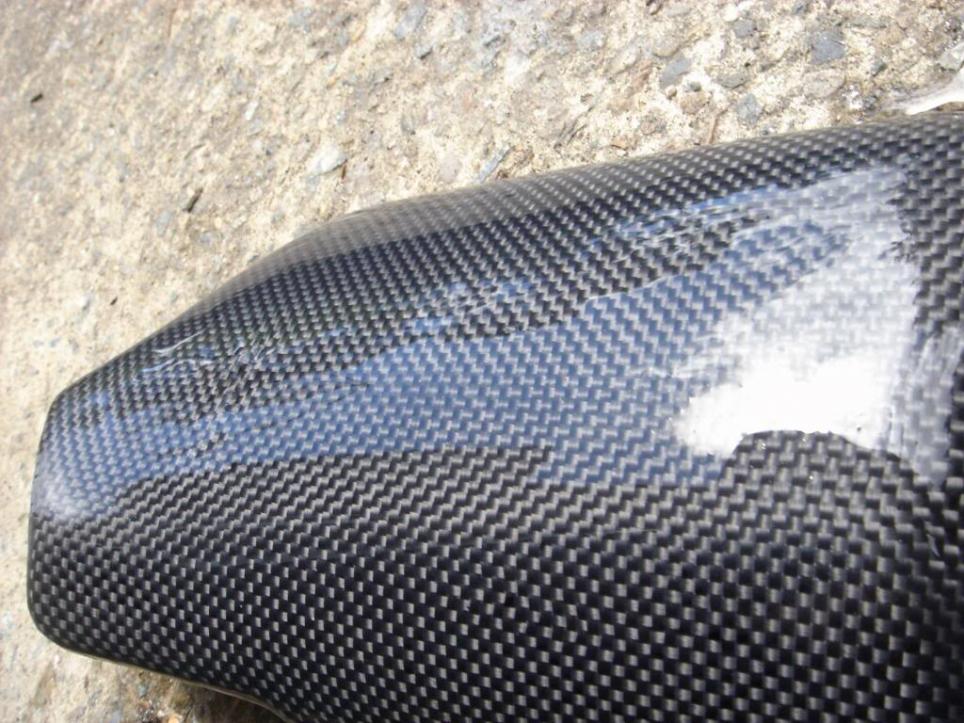

                    I spend a good half of yesterday wet sanding from 320, 360, 400, 600, 800, 1200, 1500, 2000. Made a very dramatic difference.
                    Left is after sanding and right is before sanding
                    I also applied a layer of clear for UV protection but I was overly excited and started buffing and polishing which actually striped the clear coat off. . I will have to wet sand from 1200 and wait for the clear to cure for a day before I polish again, anyways here is how they look atm.

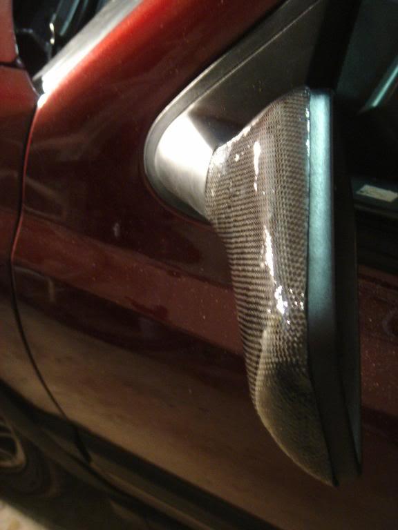

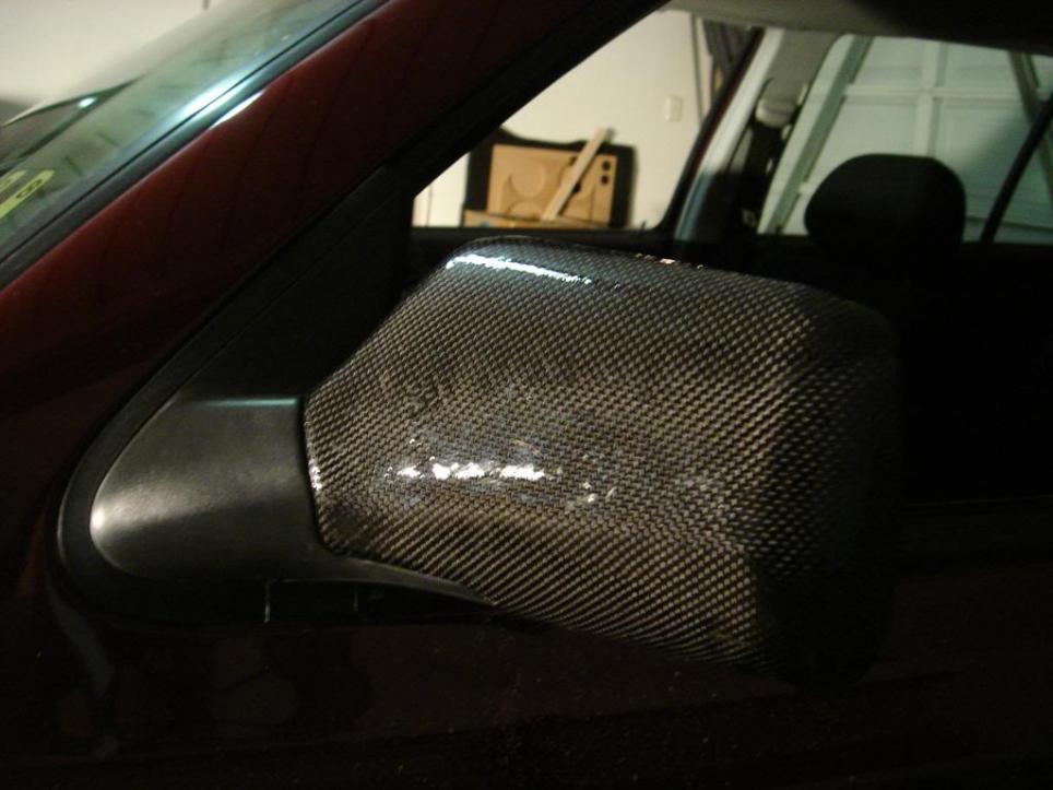

                              awesome work louis. are they much lighter than the stock mirrors?
